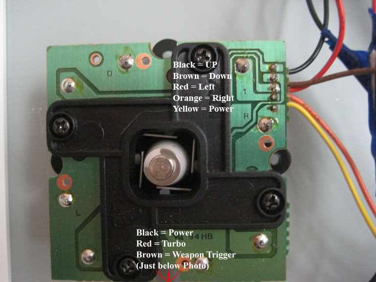

this is what the base of the Saturn/PC/Dreamcast stick looks like:
if I find a better pic I'll post it up but yeah the console sticks are just a PCB sandwiched between two little pieces of plastic.
EDIT: The pic above is the Saturn/PC Stick this is the Dreamcast stick, they're a little better but still pretty terrible compared to the arcade sticks

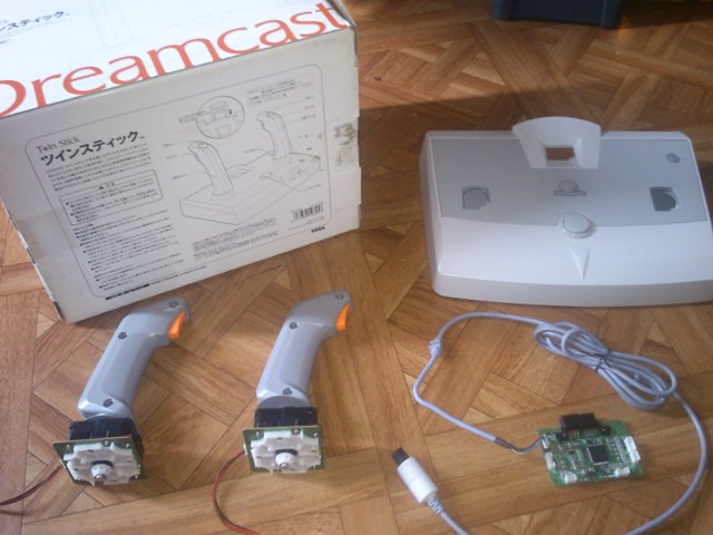

I recently got a Dreamcast twin stick from YAJ and thought the build quality and the feel of it was pretty damn good :( I guess the arcade version is designed to cop a much harder life than a console equivalent though. Is there some way of improving the console sticks to make them stronger and more like their arcade brethren without completely ruining them for Dreamcast use?
The Dreamcast stick was infinitely more affordable than the MSBS 5.66 setup that I saw pop up on YAJ and hopefully I won't break it :P
The Dreamcast sticks aren't bad reliability wise. They're better designed than the Saturn/PC sticks, and they aught to be as they're modified version of the Seimitsu LS-56. They do take more abuse than the normal Seimitu 8-way sticks since the shaft is a lot longer (which means more leverage and more stress) and I'd suspect the anti-rotation setup weakens the base and put it under a bit more stress as well.
As long as you don't abuse the DC sticks and you keep the spring hat greased they should do you well for home use.
