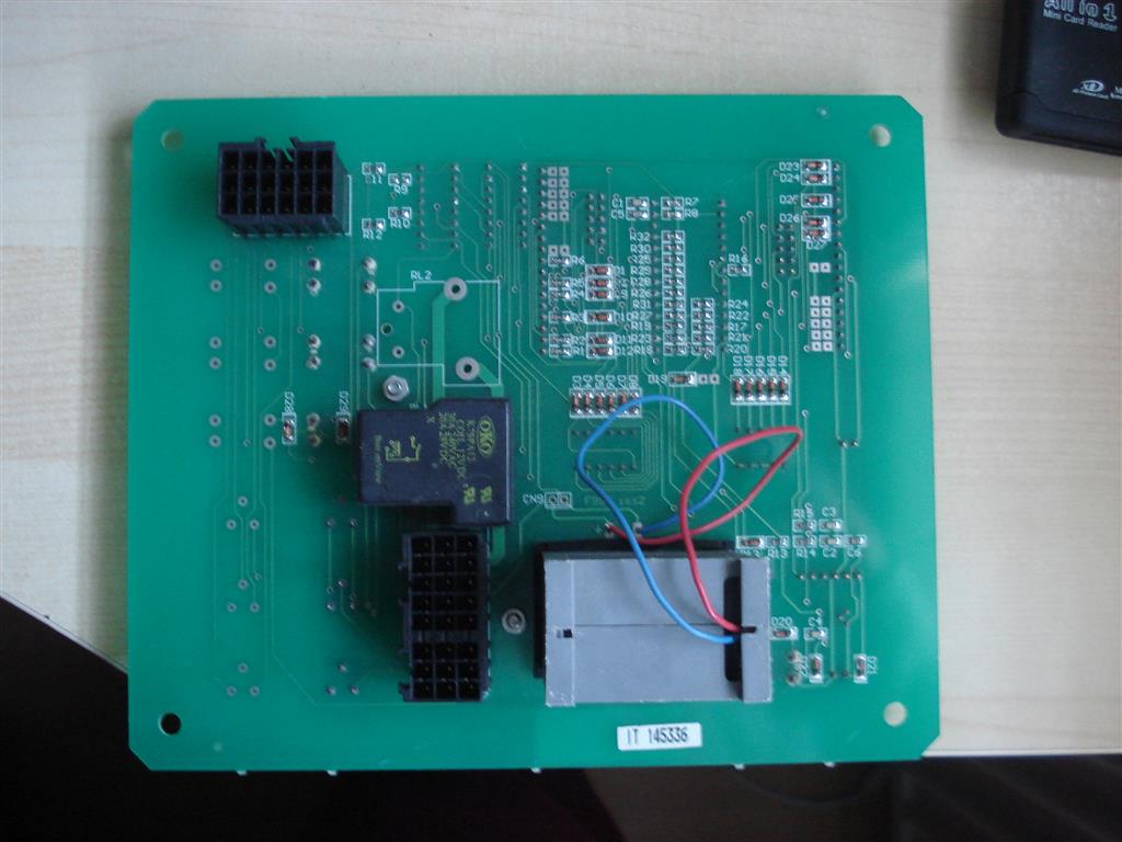

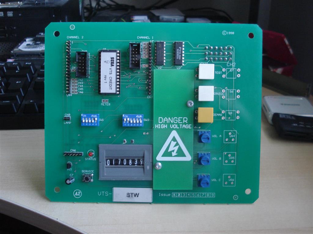

So the work continues on the Sega Rally 3....
I have two connectors hanging out the side that should go to the coin tower.
1) 4-pin - Bottom left on diagram.
2) 9-pin - Top left on diagram.
And I've found a spare VTS-STW PCB in the bits box, which is a single cab unit - no cables though.....

How do I wire the damn thing up and what order are the pins laid out on the connectors?
Can I assume the pins are in the same order as this lifted from AO. ie looking into the female socket on the back of the pcb pin 1 is the top right corner where top is designated be the catch?

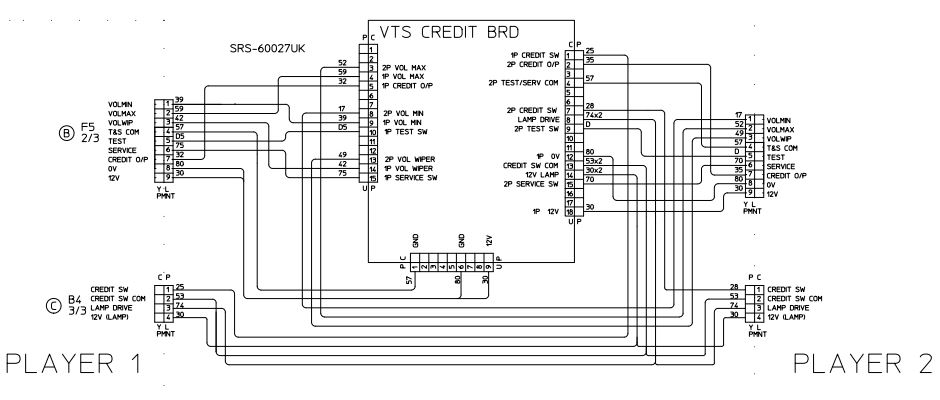

gone over the diagrams and it looks like.
4-pin goes to 18-pin only.
1-1
2-13
3-8
4-14
9-pin goes to the two other connectors.
9-pin.
4-1
8-6
9-9
15-pin.
1-9
2-4
3-14
5-10
6-15
7-5
So all I need to do now is find the right connectors in the bits box.
