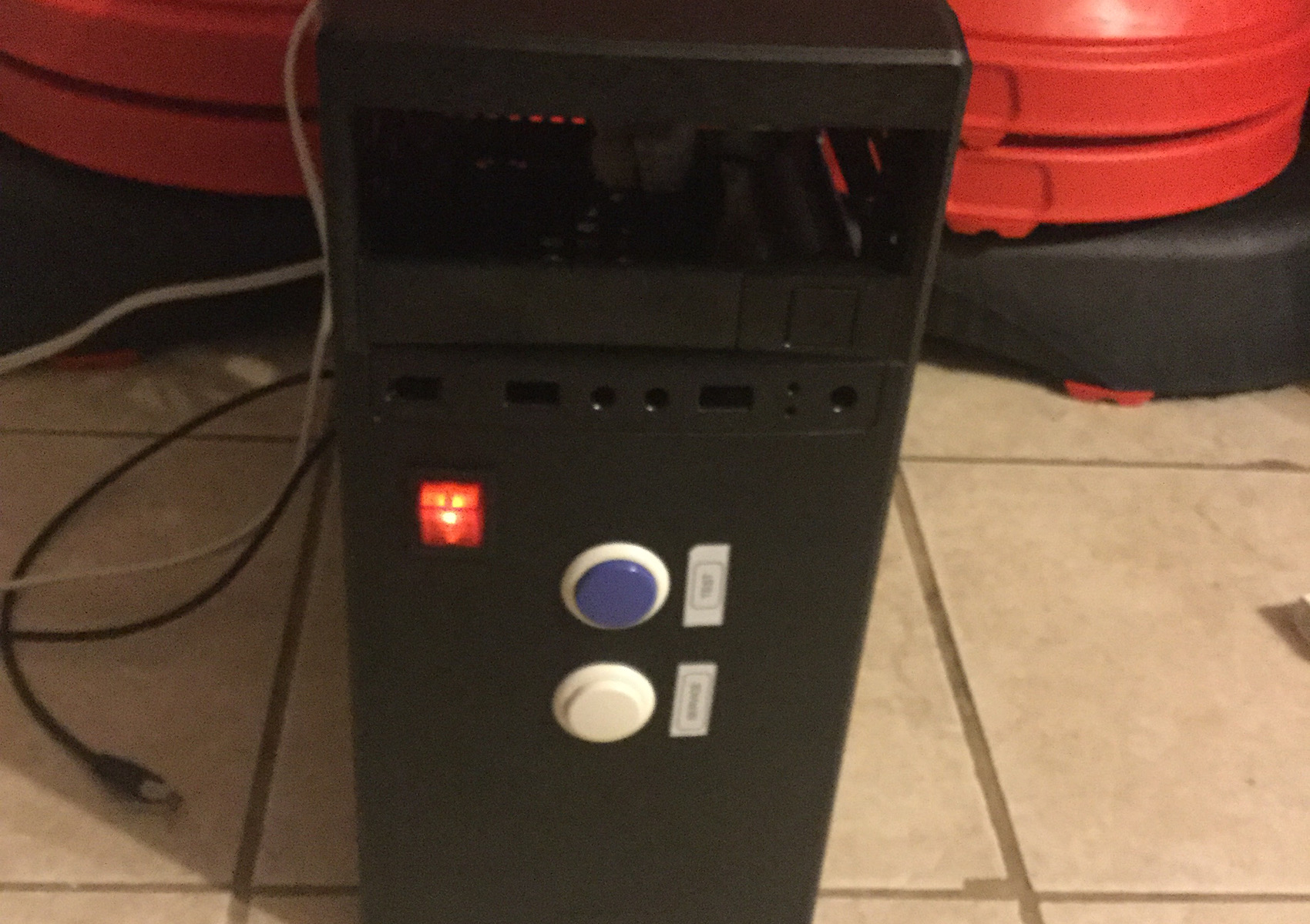

I pulled something like my last link and it seems fine. Dpst and has a light. It’s from an American dj pc-100a that has 8 of these switches and 8 outlets. It has an led and you can wire it to ac, so no need to figure out 12v.

and there is that lol, yeah some switches have a light that works off line voltage.
Yeah this was pretty simple. I was making it more complicated trying to use that 19mm round latching switch. These switches are pretty reliable and cheap to replace so I like them. I have around 6-7 of the adj 8 outlet units and so far just one switch failed in the 10 years or so I’ve been using them. The adj ones have 4 terminals, the ones I ordered look exactly the same but have 6. So they can switch off 3 terminal. Really I should probably be attaching Earth ground to the psu chassis right and plugging into a 3 prong socket? I suspect a lot of people don’t bother since the sun psu just has a 2 terminal connector.
