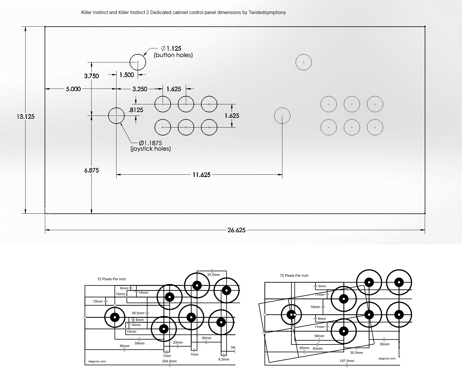

Any chance anyone have a custom CPO for a Midway cab? (Mortal Kombat, Killer Instinct.. they all have same CP size.)
I have a MK1 cab that I would love to make a "comfortable" CP for with some nice art.. (I will keep the original ofc, but buy wood and make a new one)
The classic Street Fighter 2 / Killer Instinct layout is not very comfortable to use :(.
So I thought Id make my own but I am to bad at doing these graphical things.
CP is 675x335mm. (button and stick holes are supposed to be 28mm)
My thought was to use the same spot for the joysticks and then change the buttonlayout according to the lower ones in the picture.
Obviously the buttons are to big as they are in the lower part of the pic, but I just put them there to show the layout.
What are the chances that anyone already done this? Man I wish I was a graphical wiz :(
