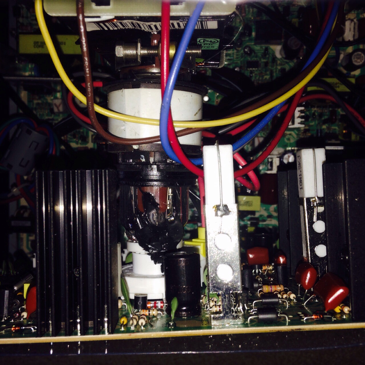

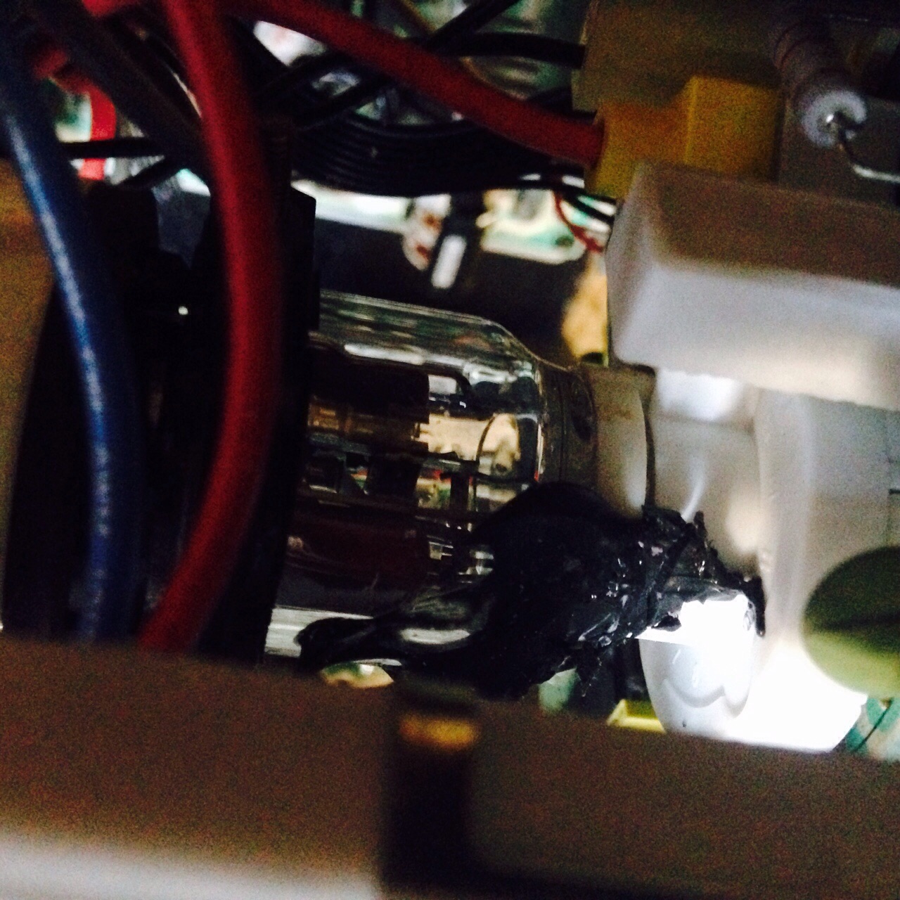

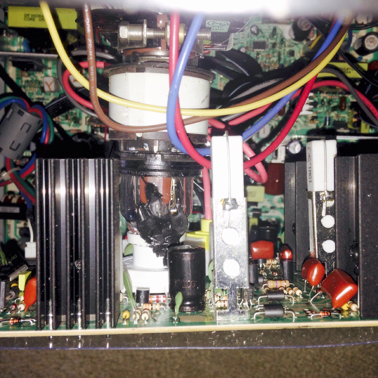

Hello.. So I hit the monitor on the back where the board seats while moving it.. The light bulb looking thing came a bit loose from the back of the board and I start hearing a sound like scaping gas.. I walked away.. Today I insert the bulb thing back into the board, and plunged it in, then sparking electricity started coming out from the area where the light bulb got loose to the board.. I guess that I did not push it in all the way or it needs to be sealed somehow.. My questions, how hard is it to repair? Is the chacy still good? Is the monitor gone? Is it all junk now? This is a NOL monitor with less than an hour of use.

Oh damn, the tube is done for; a sad day indeed ;( . But the chassis might still be good.
Ohhh noooo...Could you elaborate on why the tube is gone.. I am new to arcade monitor tech and how it works and I am afraid of electronics and electricity..
The tube is a vacuum. Sadly when you cracked it the seal was broken and the tube is now trash. There is no way to fix it anymore as the days of crt tube manufacture and repair are gone. You can try to find an old 25 inch tv and swap the tube. That's your only option now.
Save the chassis/neckboard/yoke/rings... Sometimes you can repurpose a normal TV tube(s) with these components and it will actually work.
Most of the time however the pins on the neckboard won't line up, or even if you can get it all together it has horrible/unusable geometry.
Not a simple/easy job by any means, maybe you just want a OSSC and a LCD. ;)
Yup you've "necked" the tube which basically means you've cracked the glass and broke the vacuum.
The tube is one giant piece of glass from the screen you look at to the "lightbulb looking thing" that the neck board plugs into at the back. the "neck" of the tube is the thin portion at the back and is EXTREMELY fragile.
I've necked a tube before, Thankfully mine was on a badly burned 19", but it still sucks... stay in this hobby long enough and you're bound to do it at least once.
chuck the glass and save everything else (including the yoke, yoke wedges, frame, degauss cable, and of course the chassis etc.), The WG D9200 are nice monitors, I've got a few myself. you'll need to find a new tube with the same style connector on the back of the neck. I think there are some cross reference tables on KLOV for which consumer TVs have which style tube connector. 27" tri-sync tubes can be tricky to source though.
As long as you keep the yoke you shouldn't need to make any other modifications to the chassis to make it work with a different tube. you WILL however need to do a full convergence on the new tube, after you put it all together, which is another job in itself.
