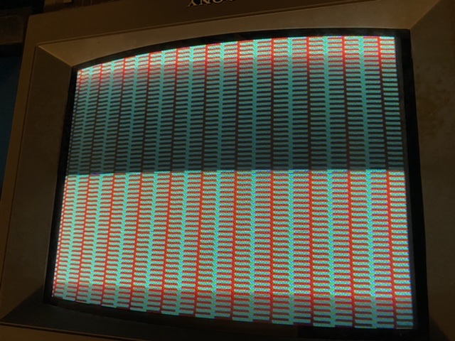

Does it look like this?
I booted up my battery Third Strike last nice night and was greeted to this. ;(
I’ve tried cleaning the cart’s edge with isopropyl, reinserted it multiple times, made sure the voltage coming in was on point. Still nothing but this screen.
The last time my battery was changed was about 5 years ago by @Mitsurugi-w. Could it have suicided?
That does look like suicide. Sorry.

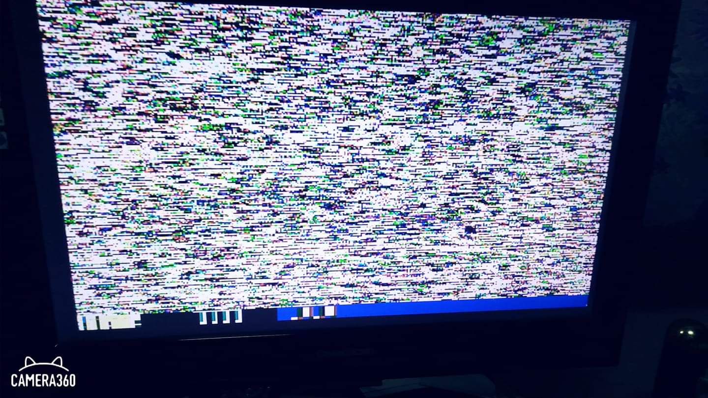

This is my 3rd strike display same with the new generation cartridge
