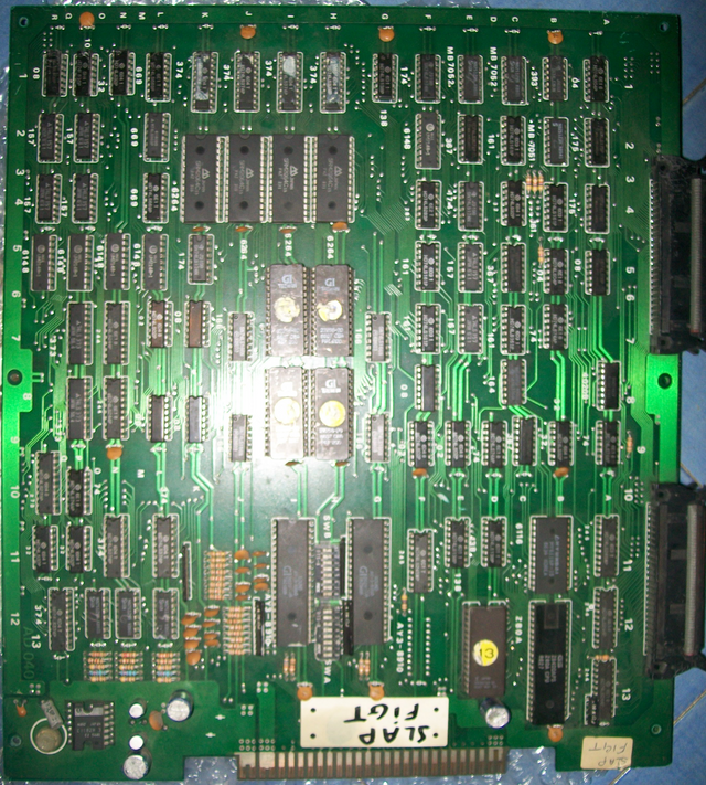

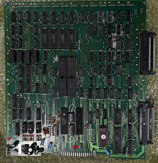

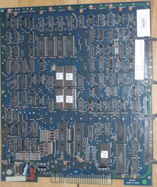

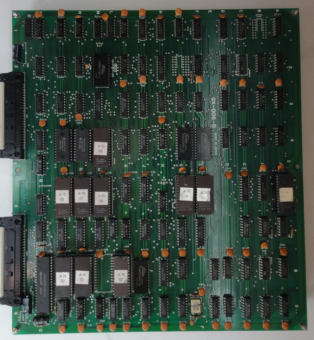

OK, so I got this Slap Fight I'm trying to trade and I have no idea if it is legit or bootleg. So a legit SF came in two flavors, a non-JAMMA green PCB with labeled EPROMs and a silk screened code on the top PCB, and a blue JAMMA PCB with similar markings. I'm also posting a picture of a bootleg SF with a very different sound area EPROM stickers that suck, and overall cheaper looking parts.

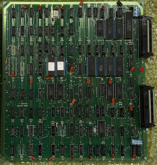

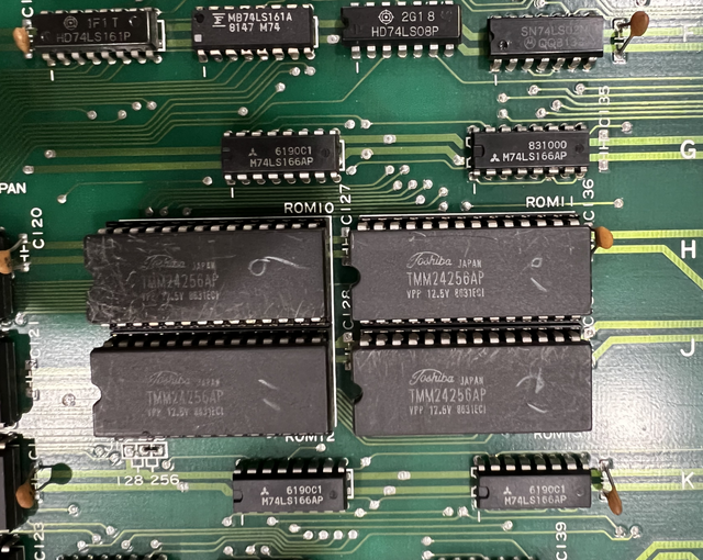

Now look at my PCB. It is non-JAMMA, missing the code on the PCB top and instead of EPROMs I have mask ROMs. WTH? Would a bootleg have mask ROMs? There is a code on the bottom PCB that matches the code on the JAMMA legit PCB.
I'm confused, what do I have here and what is a fair value for what I have?

pencil markings and those little circle stickers on ROMs are typically indicative of a bootleg. It does seem to be decently constructed for a bootleg though.

Thanks, I'm guessing so too, but was hoping it wasn't! I guess I'll need to figure out value and sell it off, I don't have an adapter for it and I don't really keep bootlegs!
