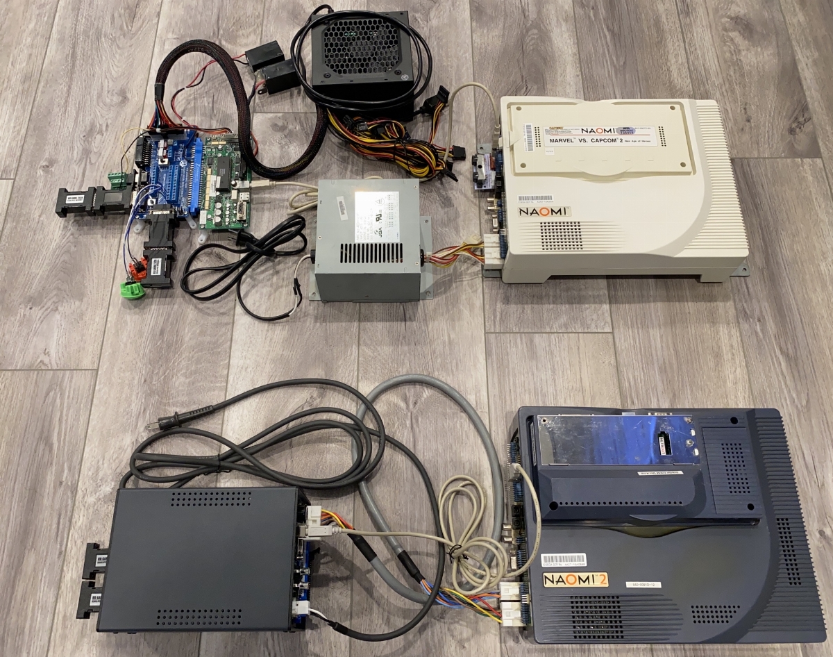

Axun JVS/JAMMA Supergun for the win!!!
we even make an adapter to power the RASP pi on netdimm multi
look at before after pics ;)
