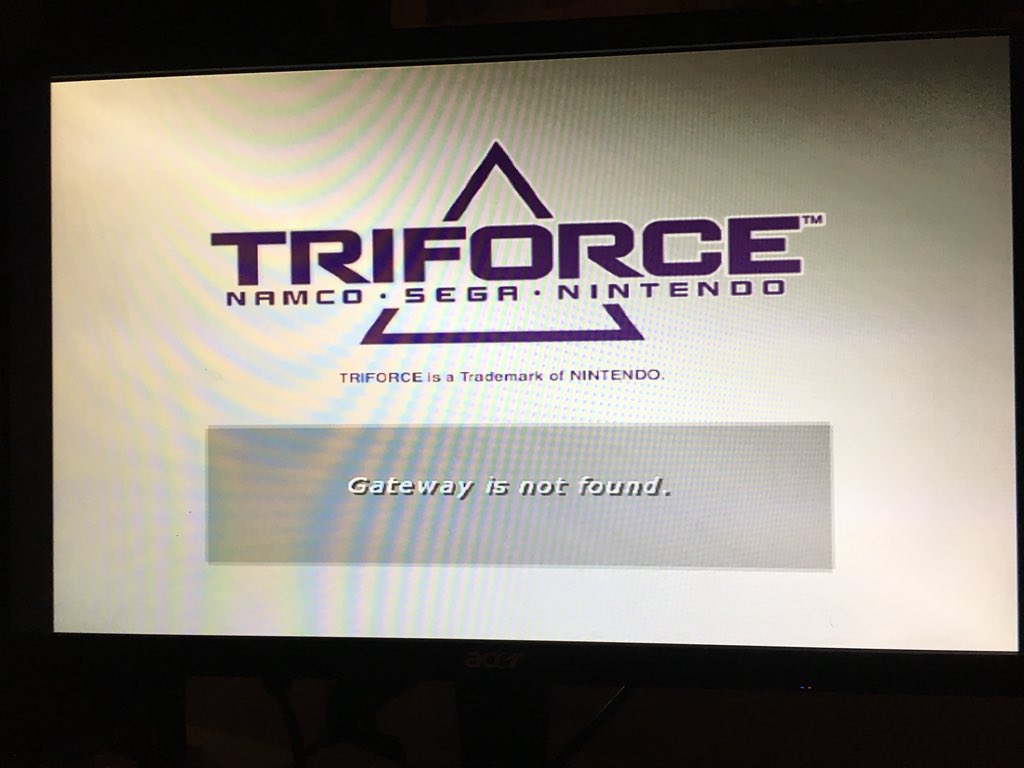

I've been able to at least get to the IO detection screens on
Mario Kart and Mario Kart GP2 on my Triforce Type 1
I noticed about 11 months ago "mkartag2" was dumped via this tool:
https://github.com/FIX94/triforce-nand-iso-extract
I'm unsure what happens IF you can get the IO board settings happy. GP2 seems to hang if you go into the Game Test mode and disable things you'd expect to break like Card Reader, and Camera.
I've always *assumed* this list of rules was correct with regard to what would boot where, but it may be dated?
Mario Kart handles about the same way, you can Go in edit the settings in the Game Test menu at the very least
Even if you disable the IO it will hang for a bit, then reboot with a "Gateway not found" error.
I've never seen it go past the "Device Check" screen with one OK next to "Button" before it appears to lock up, and reboot.
"Gateway is not found" - Error 33 (flashing)

On a chihiro, the model 1 and model 3 differ in partition setup. The partition used for network communication mbcom: is in a different sector range on type 1 and type 3. This could explain why it's giving you a network related error. The games probably always assume there is a working network adapter.
On chihiro, the netdimm shows up as an ide drive with different partitions. Two of those is redirected to 2 regions in a flash chip mbrom0: and mbrom1: They contain the bootup code and the basic test menu. Another one starting at sector 0 is mapped to the netdimm sdram memory. So that partition is either 512MB or 1GB in size. There is also an mbcomm partition that is somehow mapped to some memory area on the network adapter. I haven't discovered the details of that yet. Mame chihiro is capable of emulating some of it's communication to keep the startup and game code happy, but there is no network emulation yet.
