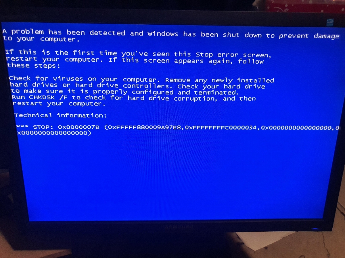

Sorry for the necrobump but I'm using the opportunity of a corrupted HDD to install this build of groovymame.
Only way I could get the USB to be read was when I changed the BIOS from Legacy to UEFI - eventually got the USB to boot and the image restored.
After rebooting though, I've received a nice little blue screen :)
Anyone ever come across this before? Tried doing my searches, but I don't think there's many that has this build installed.

Yeah switched it back to legacy.
I then also tried creating a legacy based boot disk but still ended up with a bsod. Also tried clean fresh disk, but still no good.
PC is an optiplex 990. Maybe I'll just go back to a normal win7 build

Windows 7 doesnt really work anywhere near as well as Windows 10 in terms of picking up different sata/disk controllers... Thus your BSOD.
@chunksin would have to inject extra drivers (to what end) into his Windows 7 image to accommodate _all_ the different disk controllers out there.
There would be some tool out there to let you manually inject/insert disk controller drivers into an existing windows 7 installation but it just turns into a time waster some of the time - especially with branded hardware like HP who use odd disk controllers as opposed to other "white box" systems of the same era.
@mR_CaESaR try a different motherboard if you have any spare hardware. The more generic the better probably eg Gigabyte, ASUS, etc mainboard. Change the disk settings in the bios controller as suggested too.

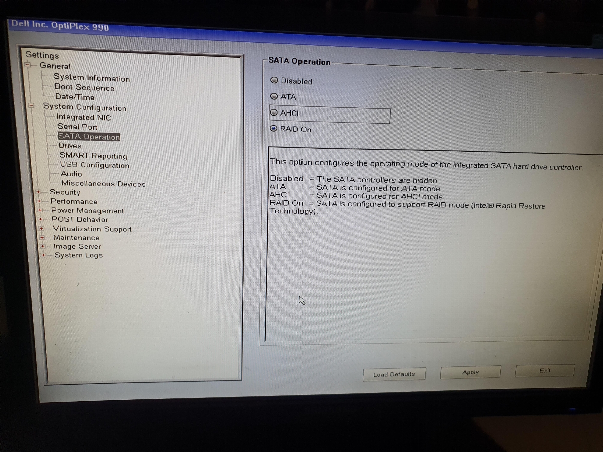

Thought I should update this post for future reference
I noticed the default settings on my BIOS had SATA operations configured as "RAID On"
The moment I changed to that to AHCI, I was able to get through the installer and everything else in the documentation
