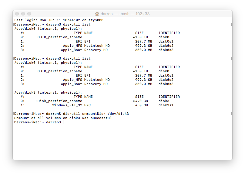

diskutil list
This will give you a list of drives attached to your computer. You'll be able to see your SD card in the list. In my case, it's /dev/disk3. Remember this as using the incorrect device in the next step may cost you all of your data and you'll be in a world of hurt that nobody will be able to help you with.
Next, you'll need to unmount the SD cart by typing diskutil unmountDisk and the location where your SD card is mounted (we got this in the previous step. in my case it was /dev/disk3). For me, the whole command will be
Code:
diskutil unmountDisk /dev/disk3
