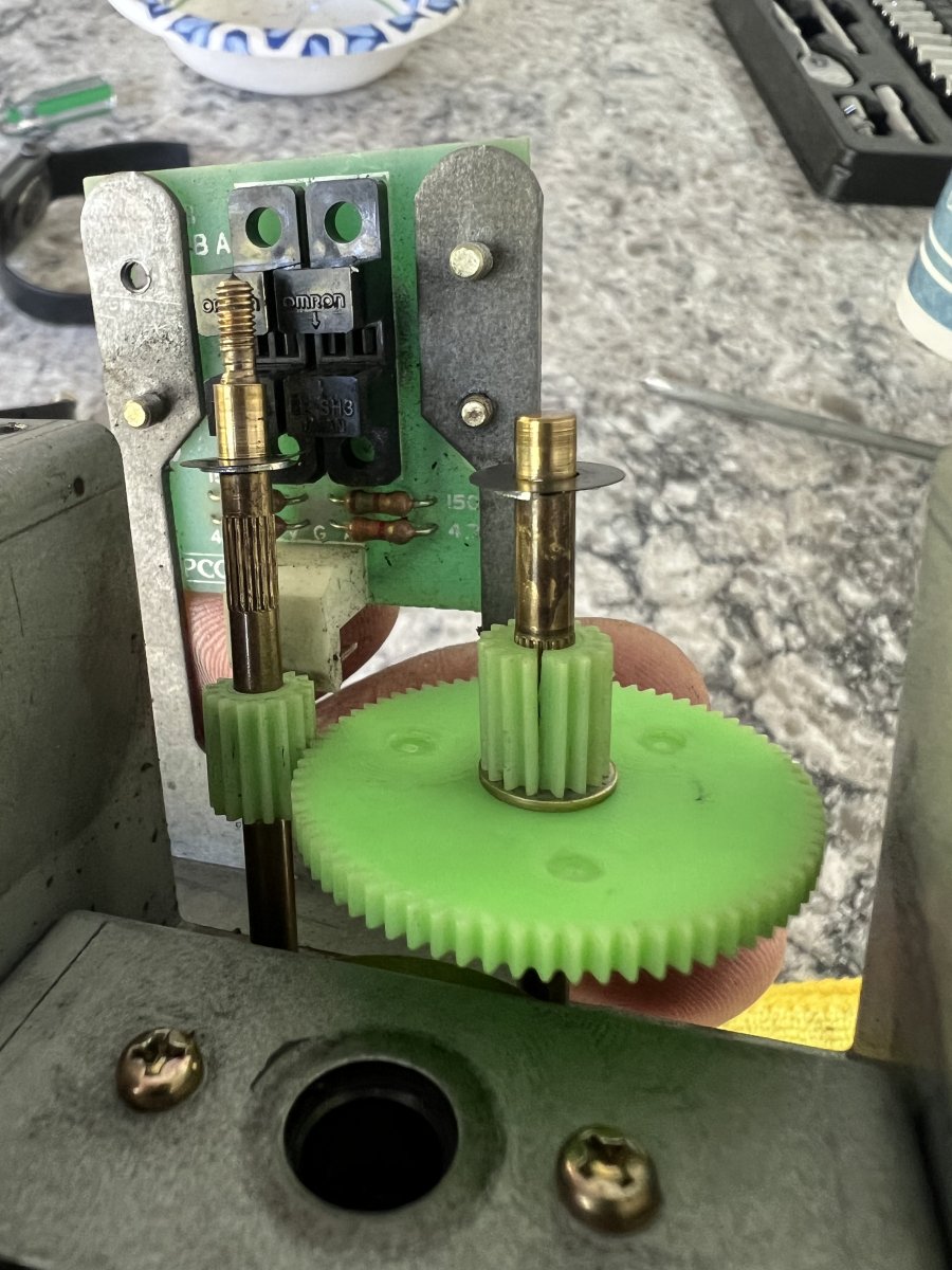

I have an original I’m looking to repair for a machine I found and purchased recently. The spinner was inoperable on player 1 but I quickly found the optical board has cold solder joints. Reflowed and it works worked with the exception that the spinner hangs up in one spot. After careful inspection I found 1 gear has a few small cracks from the shaft outward, but one of the longer small diameter is split in half the entire length. I was in hopes that I could locate a set of gears from the reproduction that was done, hoping that rebuild kits were made in anticipation of the future..
