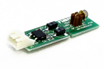

Hi, I’m trying to find a vampire night or time crisis 3 CCD CAMERA setup and/ or gun or sensor so I can do some test. I’m hoping some has a set I can buy from. This is the last piece of the puzzle to solve a mystery I have with these setups. If you happen to have the gun, the cameras or just the gun sensor it’s self, please contact me! I found some pics online of the gun sensor that is used on the arcade versions of vampire night and time crisis 3 CAM version.

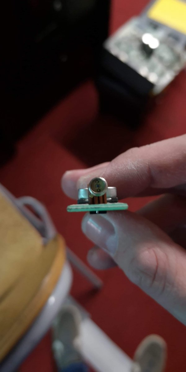

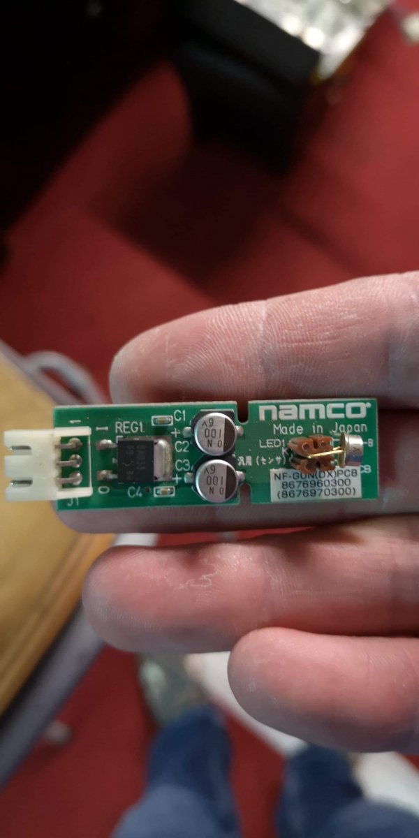

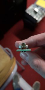

Anything? I was able to get the camera with the sensor. The only thing that is missing now is that IR led emitter. What I’m thinking is if there’s a replacement to that pcb or if anyone has replicated that. Basically, how the camera works is that it tracks where the gun is pointing and then when the player is pointing and shooting, the IR led will flash, the camera and the sensor picks it up and then the rays pcb processes that signal from the camera’s video feed. I know it’s a little more complicated than that. So if there is anyone which more knowledge with these type of setups, please, your help will be appreciated. I would like to replicate these led emitters as well. If anyone has that led emitter for sale, I would like to purchase it from you.

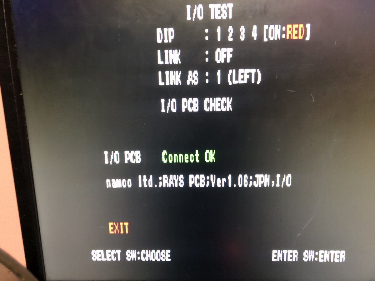

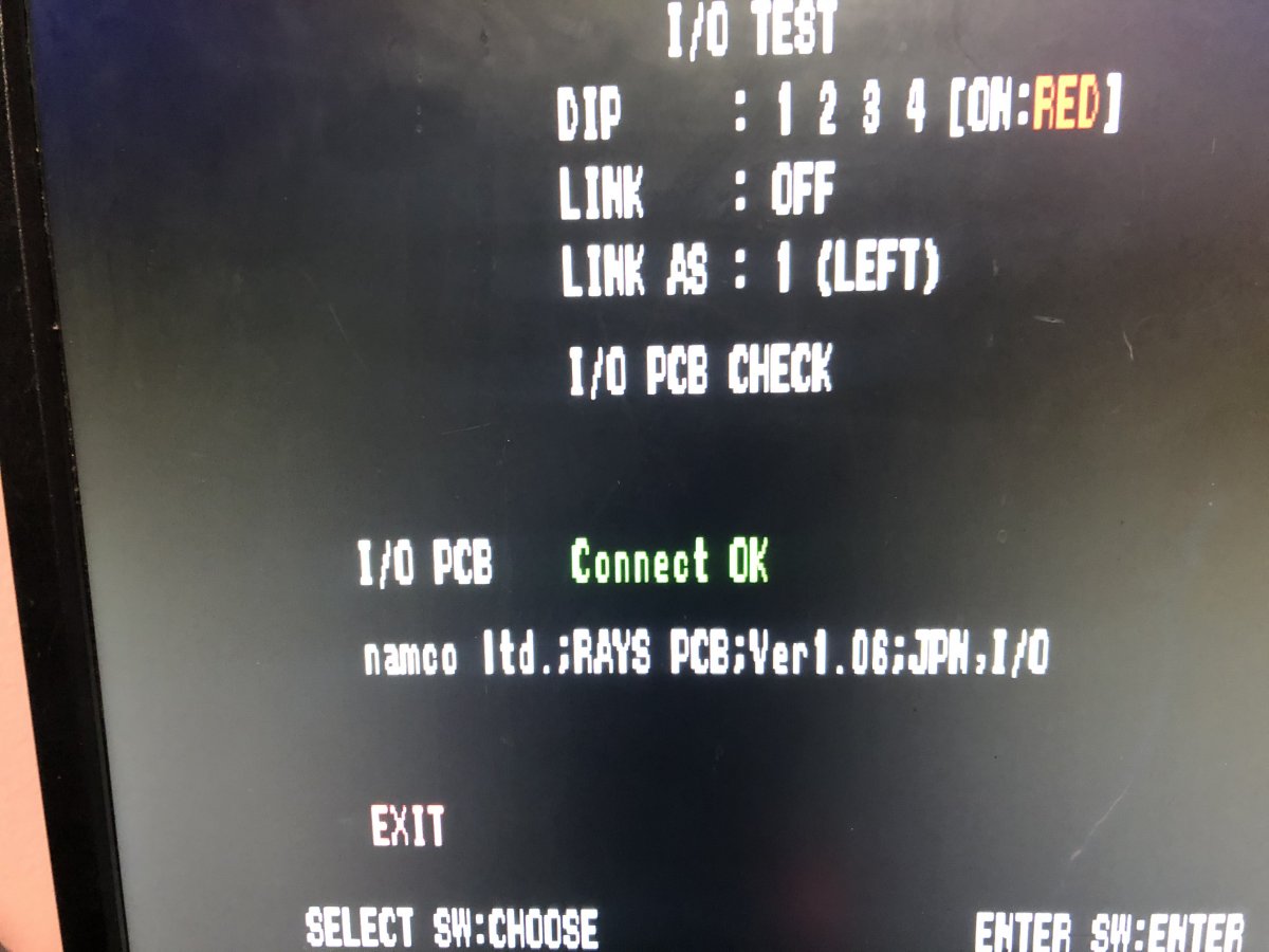

I got around to finally testing if my rays pcb even works and if my Time Crisis 3 pcb recognizes it. It does! Now on my search for that emitter!
