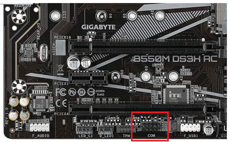

As mentioned here I went with the Gigabyte DS3H mATX motherboard for its (native) COM port.
I really want to use the original Taito JVS card so this is a MUST!

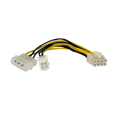

I used this Startech adapter to change the 4pin 12v motherboard connector into a 8pin "modern" style.

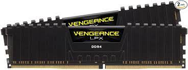

RAM I used 32GB (2x 16GB) Vengeance LPX DDR4 3600 (only a few $ more than 3200, though I have no plans to overclock this system).
