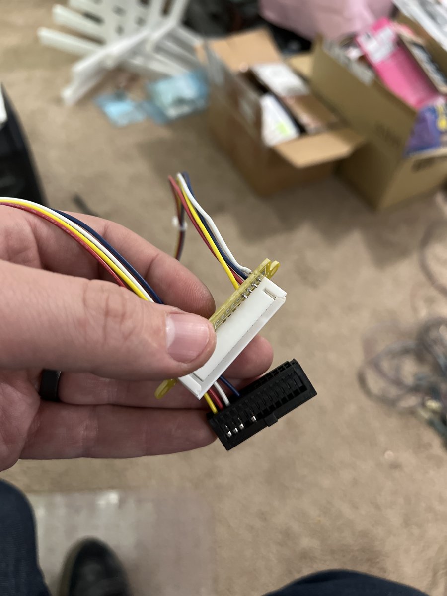

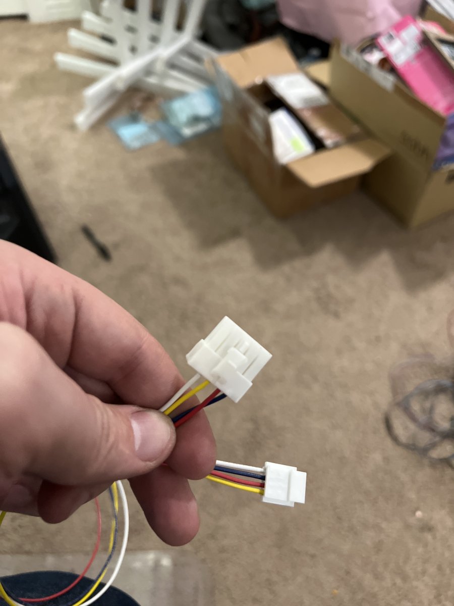

I was actually talking about an adapter that connects to either the blast's IO board, or an adapter that connects to a CPS2 kick harness that's connected the blast's IO board or, say the Extra button wiring in an astro) so that all you need to do is swap out the panel and the 10 and 12 pin harnesses. no funny business with routing wires directly, making it much closer to the Naomi/N/NC cabinets

Are you saying an adapter to plug the kick harness into the analogue plug on the I/O so the analog signal from the stick can plug into the kick harness plug under the panel?

This is actually genius! :D
For the blast, use the 10 way kick harness at the top and use pins 1-4, then at the bottom, use CN8 pins 1-4 to go into a JST RA 26 way instead of a CPS2 connector! That's clean! Do you mind if I do that and use the same idea?

I don't think you'd be able to use it for the NNC as they've got a dedicated 8 way connector for analog stuff since the I/O used on it is a JVS.
For people that would be using an astro/blast with a sega revb or capcom io, it could be made to work as their kick harness connectors are both different, one uses the JST NH (blast) the other uses TE Amp UP (astro)

This. it would only be compatible with blast/astro.
by all means, Please :) i don't have a corner on good ideas
So this:
Combined with this
Through the blast IO and you will never have to swap cables out of the blast. Connect this adapter to the CPs2 kick harness and replace the extra button harness under the CP and you’re set.
