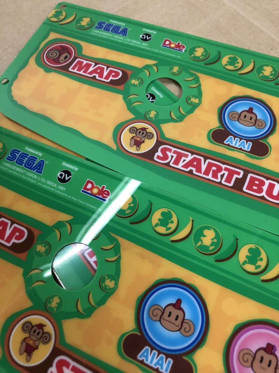

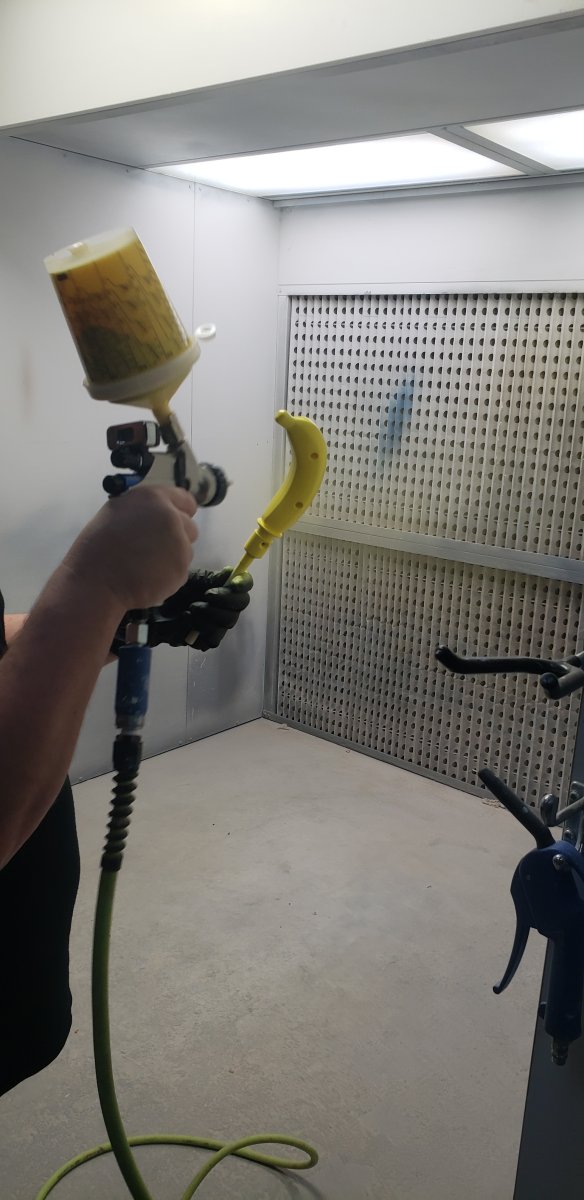

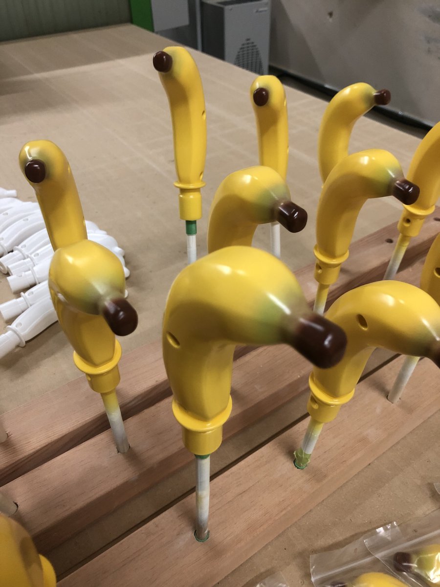

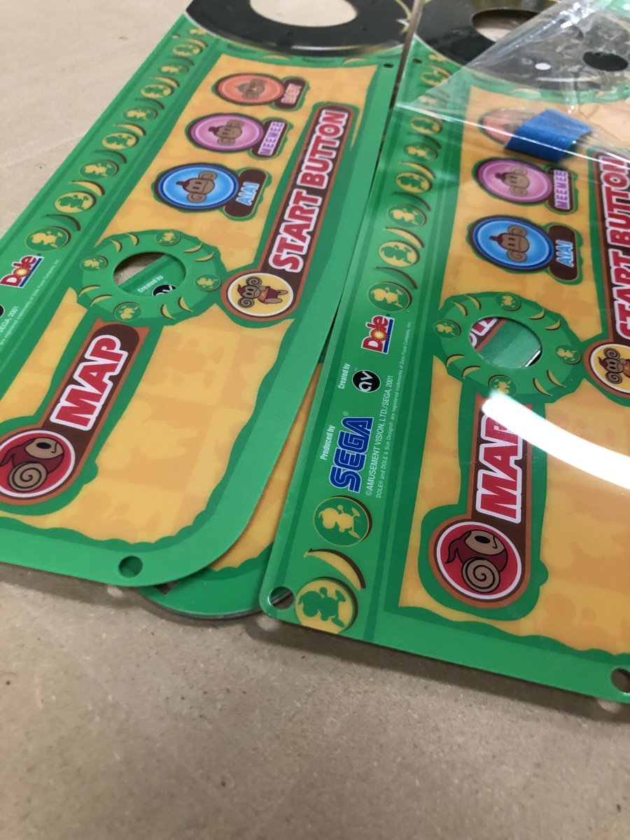

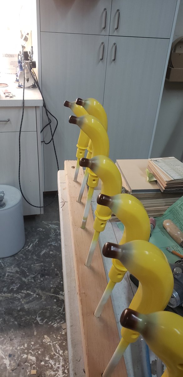

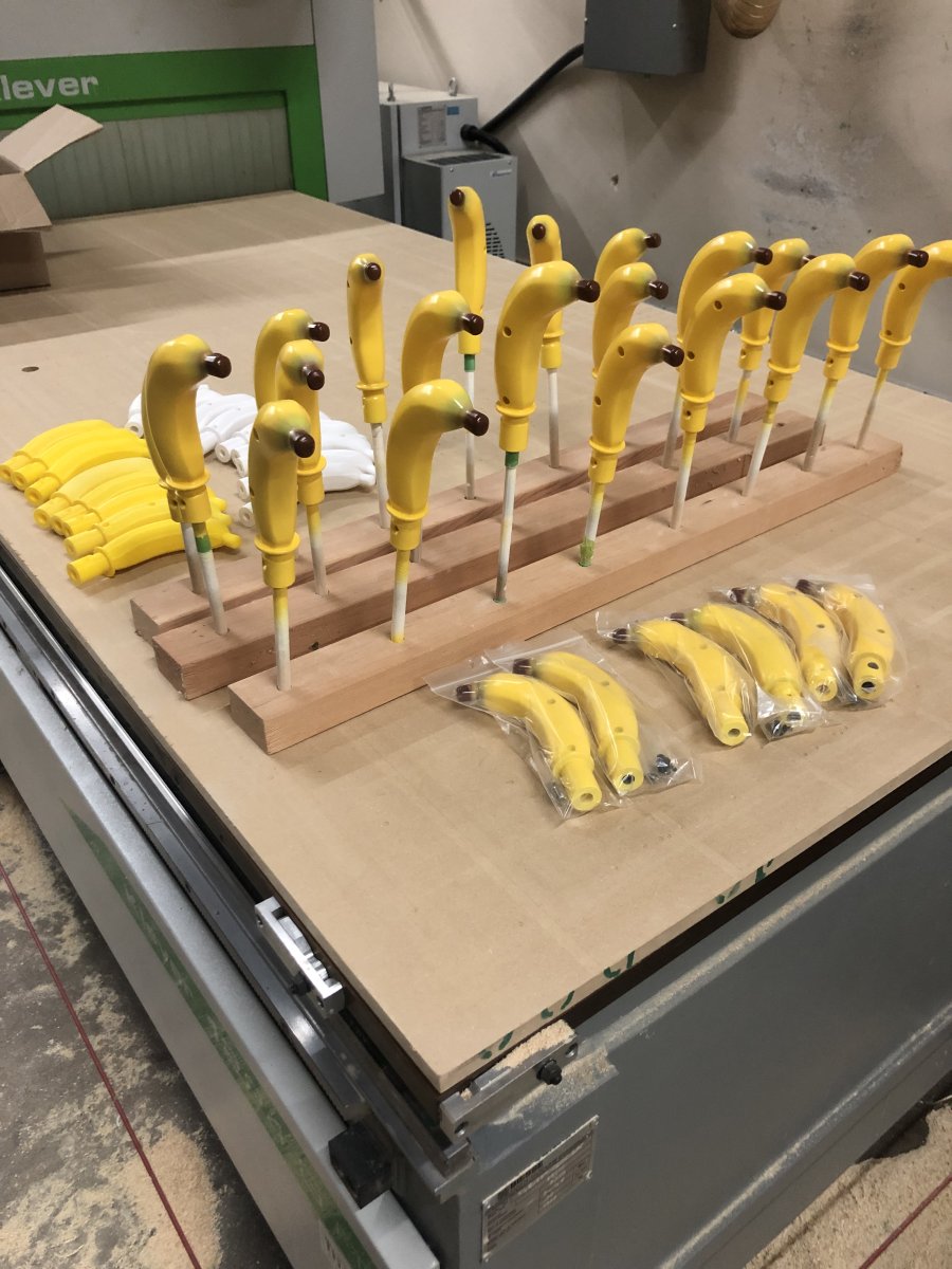

Just a little update.
Our schedule finally aligned and we got a small batch going, but not finish. I have the metal CP ordered and made. I'm getting a new CPO and will sending it over to Alberto for production. I will be posting pictures once done and you will have a choice between what is already out there or the new one. The finish will be matte kind of like the AC/BC We like it better then his gloss for this panel. If you want gloss like he use to do, let me now when I confirm your order.

Looking great. Do you have a photo to show the matte vs gloss?
Rankil
Mar 30, 2022
14
12
Detroit
Is it like gloss vs polycarb coated vinyl you get on a CPO decal? If you guys like the matte better I'll take your word for it. I'm a fan of the polycarb overlays myself.
