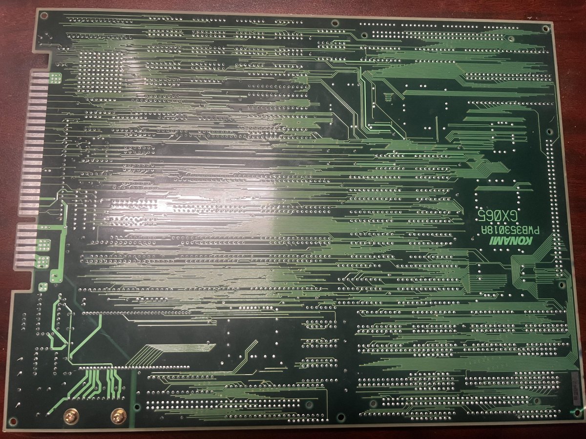

I have no idea - dont have time to spend on it
When powered on the screen displays garbage but with different images so I know it is processing
Maybe a simple fix - not sure - I just don't have the time
Did it sell for $150? If someone can fix it that’s quite a steal.
Yes and no. Depending on if someone has a donor or multiple to fix it.
Looking at the pics I could see one of the customs have broken pins. Which could explain why you’re getting garbage graphics. But who knows if that’s the only issue, it sounds like more than a single custom being bad.
These Konami boards all have different combinations of custom graphic processing QFP’s. So finding working replacements could expensive because you need a donor from another board or multiple.
Even at $150 I bulked because the price to repair would easily double or triple this cost.
Plus you’d have to be skilled at doing surface mount soldering, and these customs have an awful amount of pins.
