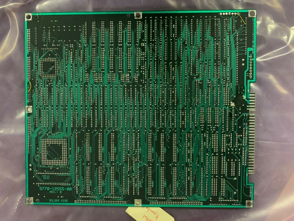

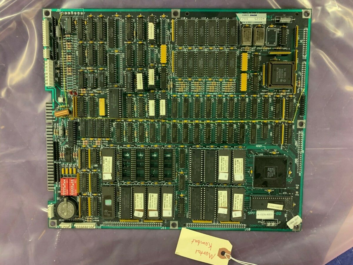

Poking around online High Impact appears to have some wire hacks on the bottom of the PCB. Note the 3 green wires
It looks like MK1 shipped on both "Rev B" PCBs WITH wire hacks and "Rev C" PCBs WITHOUT wire hacks
Note the Yellow Wires on Rev B:
well my mk was clean,
my high impact may have lost them - when i got it i paid 5$ and it looked like it had been stored outdoors!!!
infact i paid beer money for both with the sole intention of fixing one and trying to convert it! :D
that does get me thinking,
i wonder if the schematics are correct, or printed before the mods!
that's a good question.
it does seem though, that in the case of MK they removed the need for the wire hacks with the next PCB revision. perhaps that's the same with other games?
makes sense - provided they discovered the issue before making too many boards.
i wonder if the schems have the board revision on them?
i'll have to go download some again.
