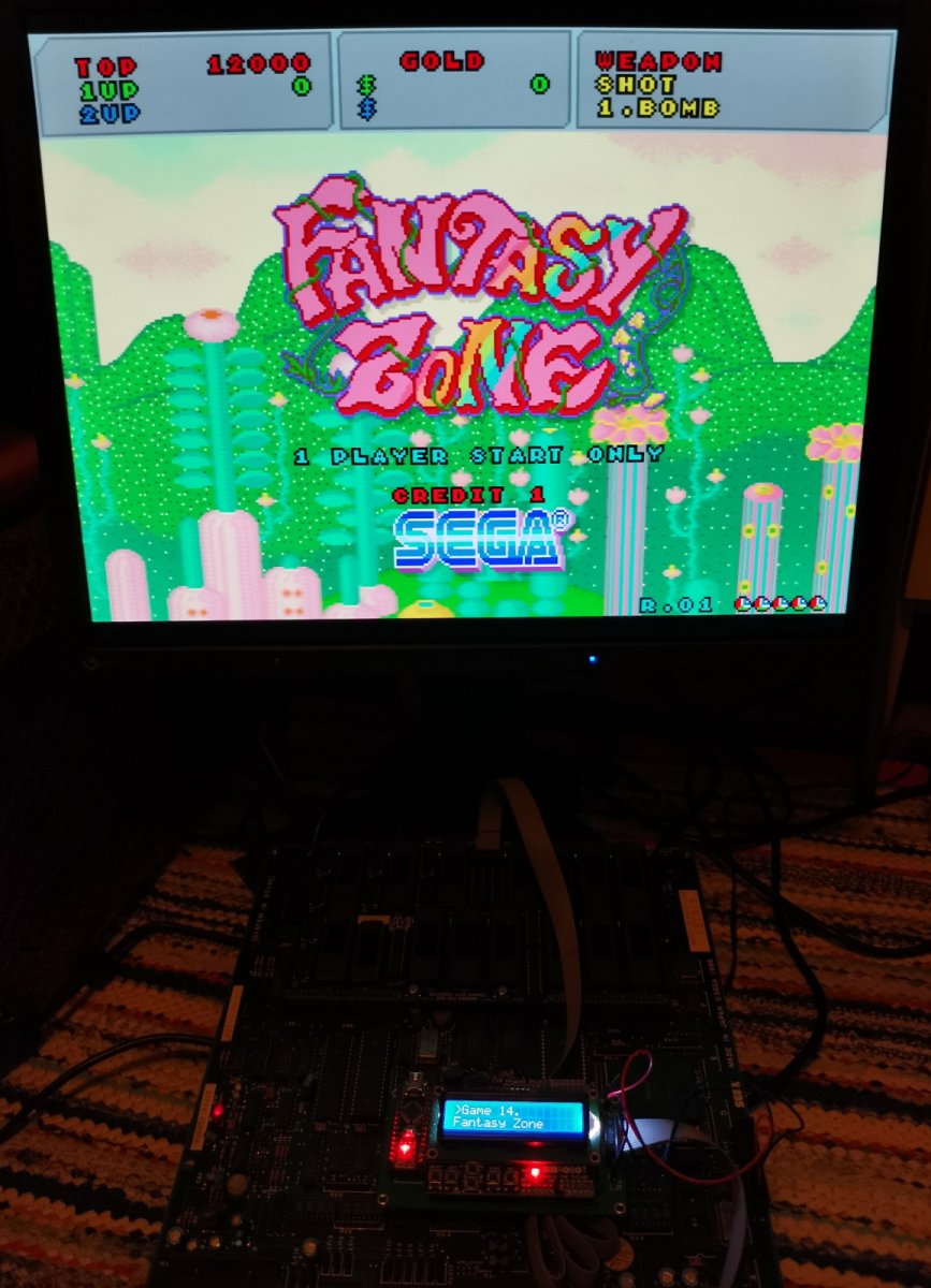

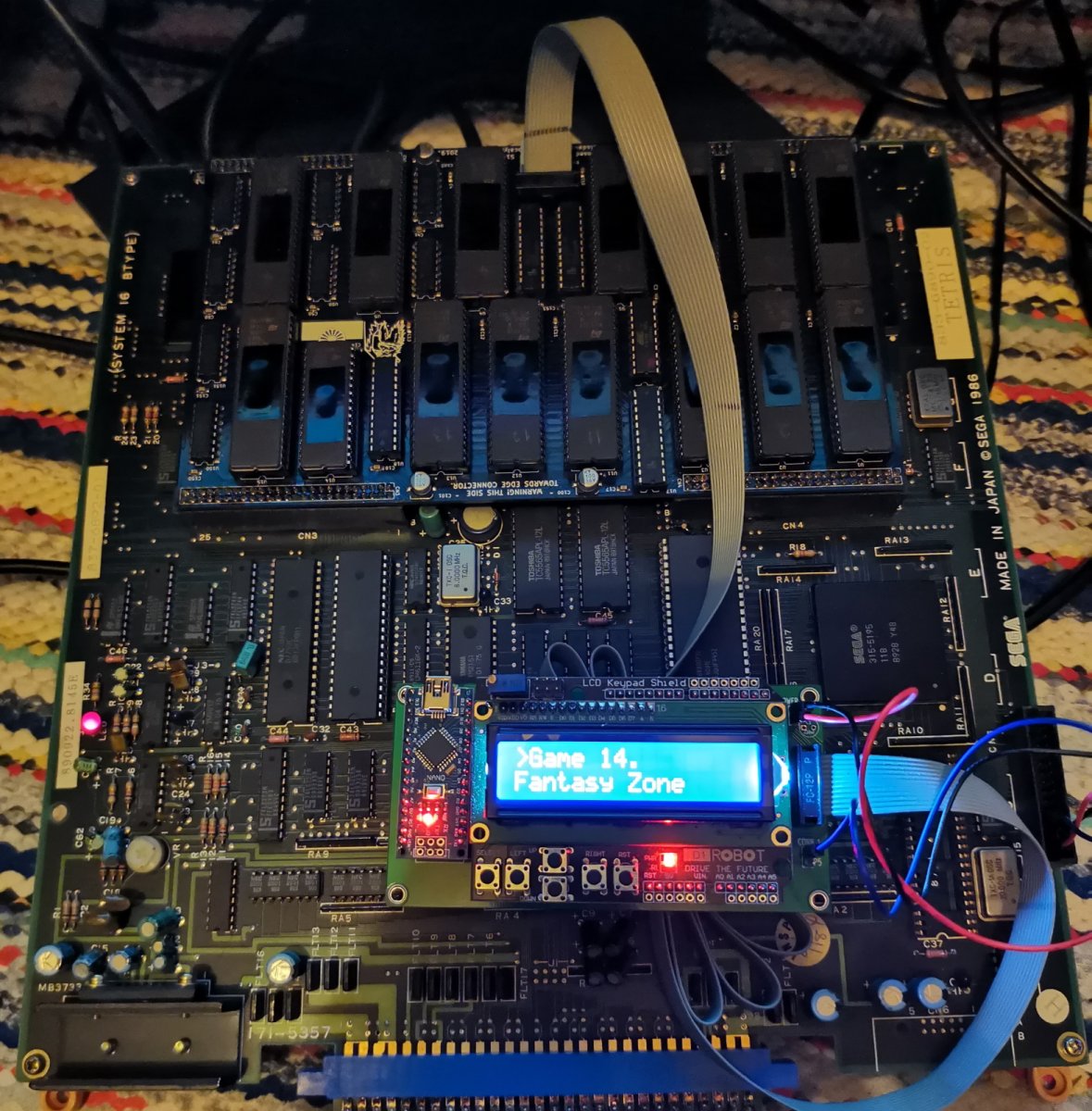

I fitted the very same selector to Sega 16B which was originally designed for Sega ST-V. The selector has no hardware changes, only differently programmed Arduino. Automatic reset is also functional, you shall select the game and push one button -> game will boot in a moment.
I shall share the program for downloading. There is no yet multi-selection option (so that you could select if it works for ST-V or S16), but I will look into this as well. Should be pretty simple.
If you want to buy another selector for the S16 use, I have them in stock at the moment. For a few Euros I can also provide a short (approx. 25cm) wire set for GND, +5V and reset.
