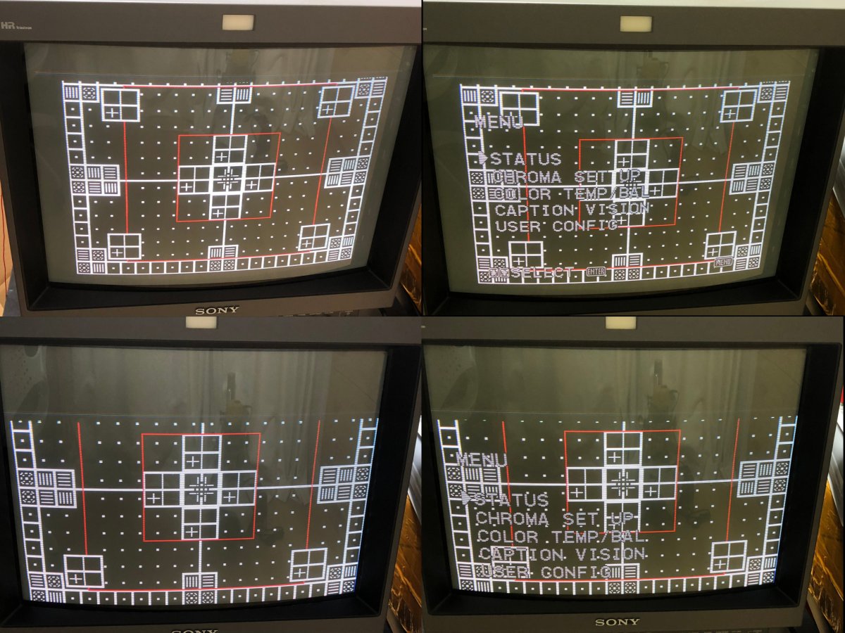

All of a sudden, I got the three lines on the top problem. I changed the two usual caps, but that made no difference. Indeed, measuring the ESR, they were fine.
I then recapped all the board, but that brought no improvement either.
With the service menu I can bring those lines up, but even 255 is not enough for pushing them out of the screen.
I attach a picture of the problem. Top row, underscan enabled. Bottom row, underscan disabled.
The menu seems to be shifted (without underscan, the last row of text is clipped out) but the monoscope is clearly not.
The yoke coil should be fine. If I make the image exaggeratedly tall, they are able to draw up to the screen border.

Any guesses on what the reason could be?
