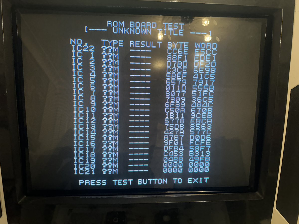

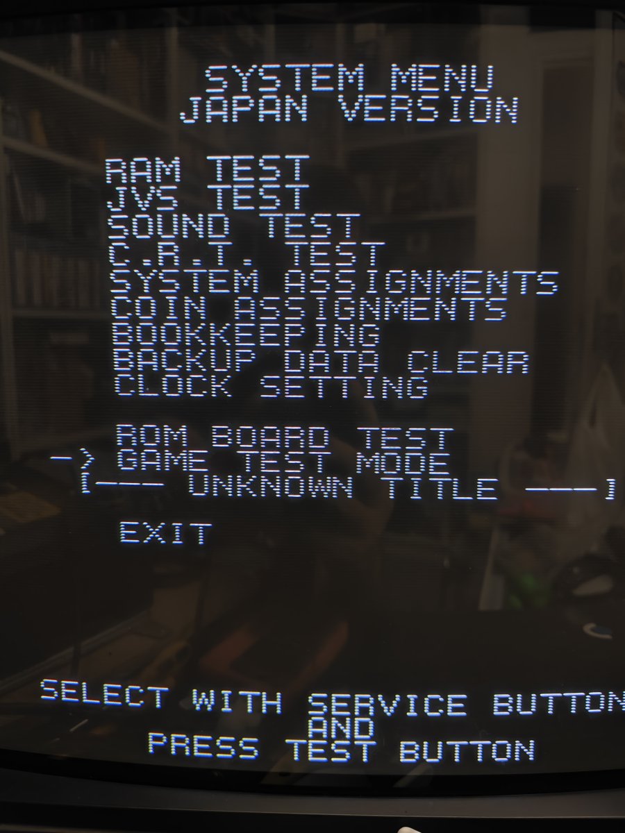

You just press the test button on the Naomi motherboard with the cartridge installed and there's an option near the bottom to do a cartridge test, it'll give you the checksum for the eprom and the maskroms.

The custom 315-6050 CPLD chip is bad, you'll need to take a replacement from a donor cartridge.

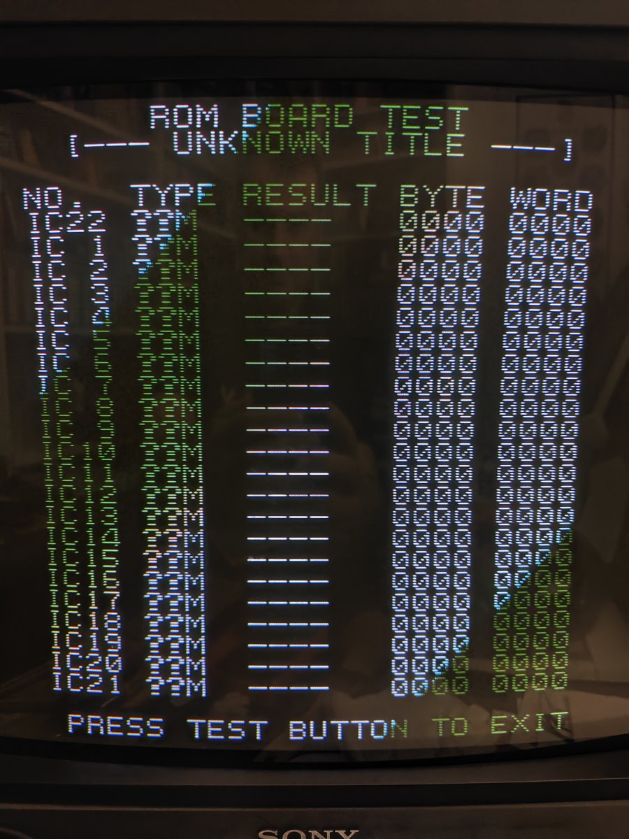

I have a Zombie Revenge cart and it consistently delivers error 01 and the following on the cart test.
Assuming it’s not the security chip and IC20 and IC21 are bad. Although I am confused it can’t recognise the IC type for any.
Zombie Revenge has no chips populated in IC20 and IC21, which is why they return 0000
the checksums and chip size are all stored in IC22, so it's entirely possible that your IC22 is bad.
