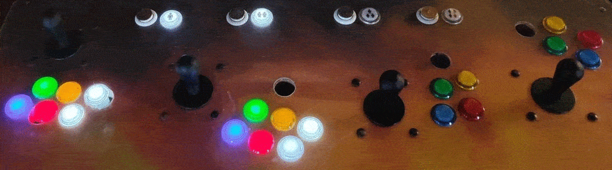

I've seen this come up a few times, and its personally bugged me for quite a while. So I made a thing. (please ignore the awful layout, ill be replacing it soon)
This works by tapping into the LCD on the CPS2 Multi-kit, reading whats sent to it, and activating the layout for that game.
You can make one yourself with an Arduino, and a relay board.
Check out the write-up here
Or just jump straight to the code
This is open-source, do what you want with it, criticize me, give me feed back, whatever.
Ill also be making some PCB's that simplify the entire process. If you're interested in one, let me know.
