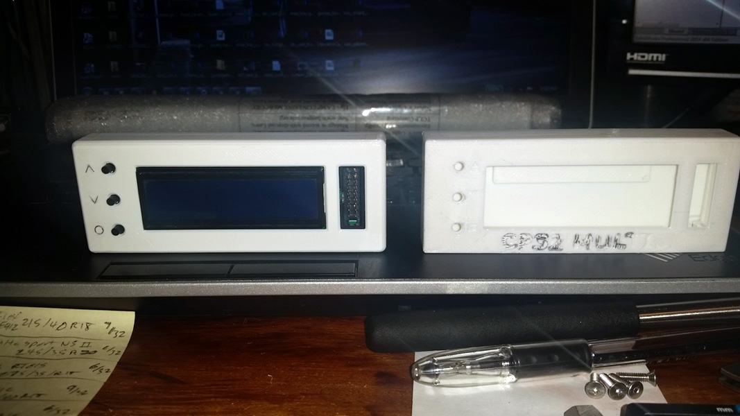

Here's a picture comparing my design to DogP's
^this is an early prototype of mine, in the final design the LCD is recessed slightly from the housing and the buttons don't stick out as much.
Also I didn't do this print of DogP's housing and this doesn't really do his design justice, I'm mostly going for a size/shape comparison here.

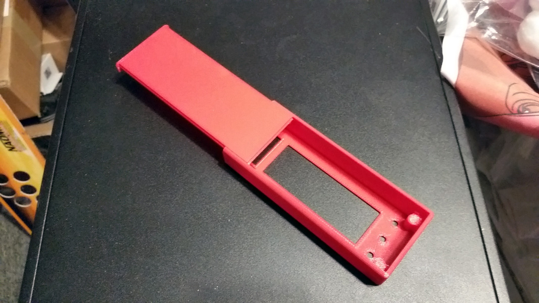

Here's how the back attaches... no screws the back slides on from the side:

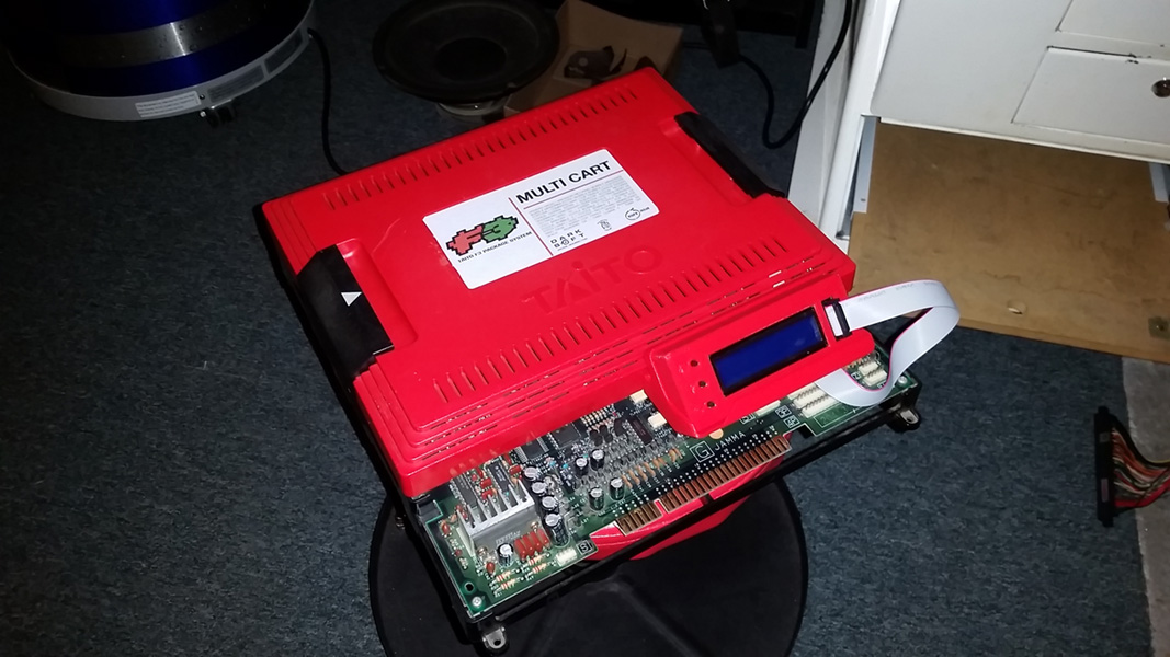

So after seeing people talking about permanently mounting their multi LCDs to the PCB some how it occurred to me that it'd be nice to have a place to put the LCD so I came up with this "holster"
this sits in place of the small removalable panel on the front of the cart housing and has a wire pass through for the ribbon cable. installs with ZERO modification to the cart housing and the LCD housing clips in place such that you could even turn it upside down and it wouldn't fall out.
the idea is that if you want it clipped in all the time you can leave it in, but if you occasionally need to use it like a remote you can easily pop it out to do so.
I still have some adjustments to make on the design and I have an idea for a similar holster on the CPS2.

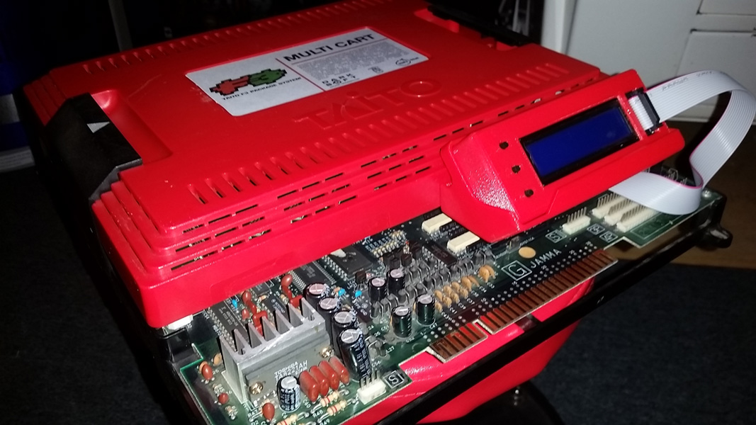

I've still got to work out the fitment against the F3 housing and there are some tricky parts to print so I might need to tweak the design to improve on that as well... I'd estimate another week or so before I can make these available
In the mean time here's another test print in red. I snapped the pic while I was checking clearances against the expansion connectors
the ribbon cable position here isn't what the final one will be like, it will enter on the right of the holster, not the bottom.

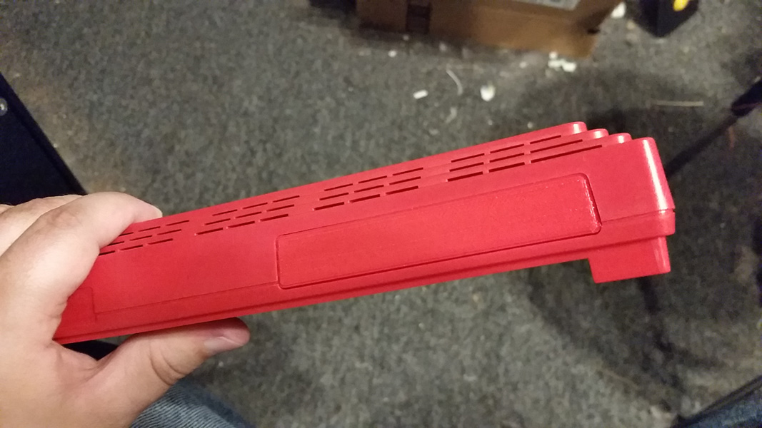

oh and if anyone is interested I whipped up a model of that little port cover:
https://www.thingiverse.com/thing:2519408
I don't plan on selling these since I doubt there's much demand for it but I figured I'd release the files to help save someone who does happen to be missing theirs... or I suppose it's nice if you want to put holes in it without ruining the original.
