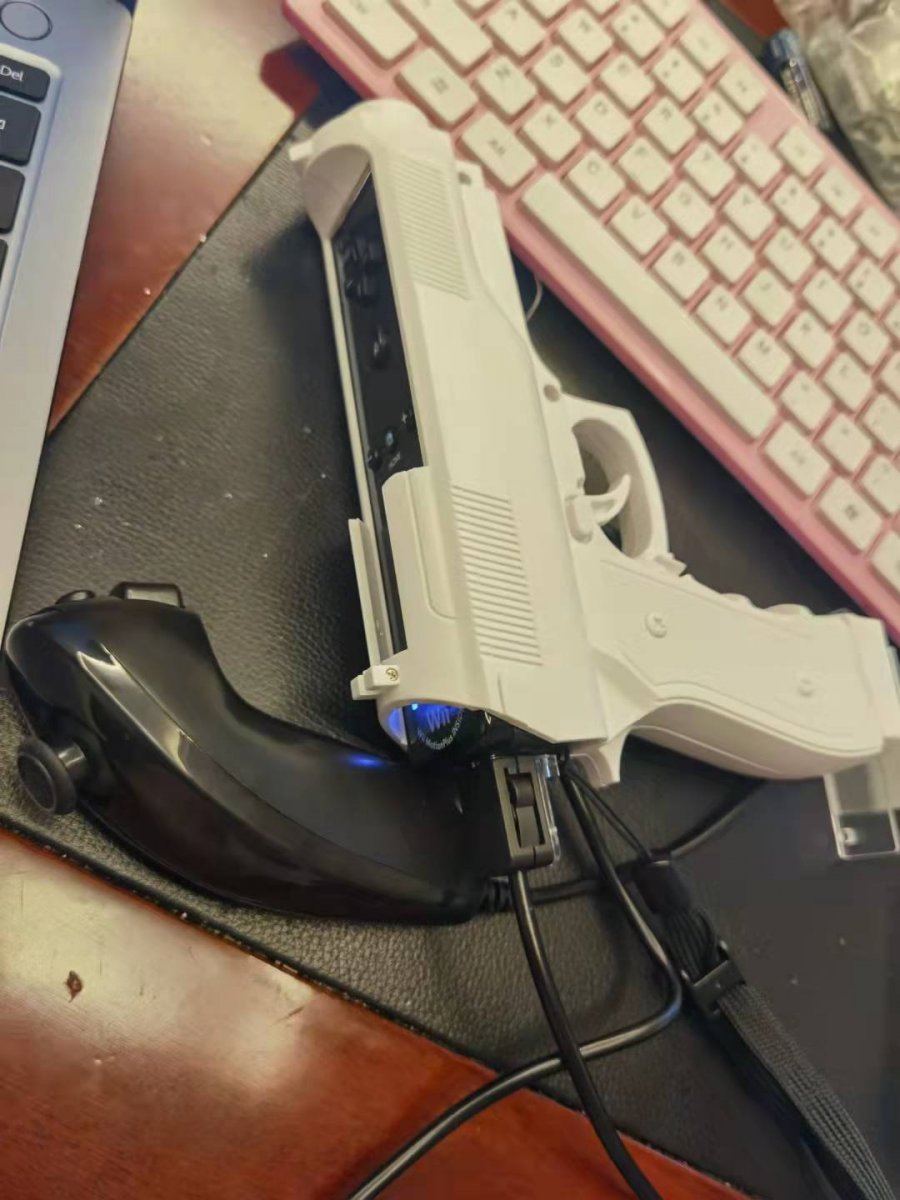

1. A original nintendo wii motion joy stick set . and a gun which fit wii motion . I suggest you nerf's wii gun.

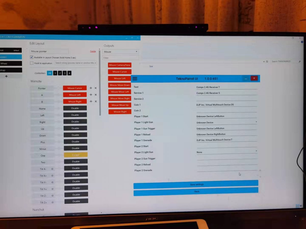

A: start toshiba bluetooth drive soft ,and connect the wii motion joystick.

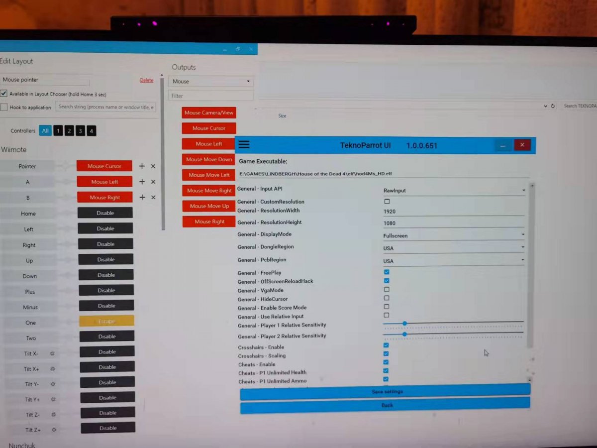

B: open touch mote soft ,and setting up your wiimotion's key . It can be mouse , touch sensor, x360 joystick . It should try by your self .but for teknopart , mouse mainly, mame, xbox joystick mainly,.
C: set up the key in game's setting .run the game and joy.
