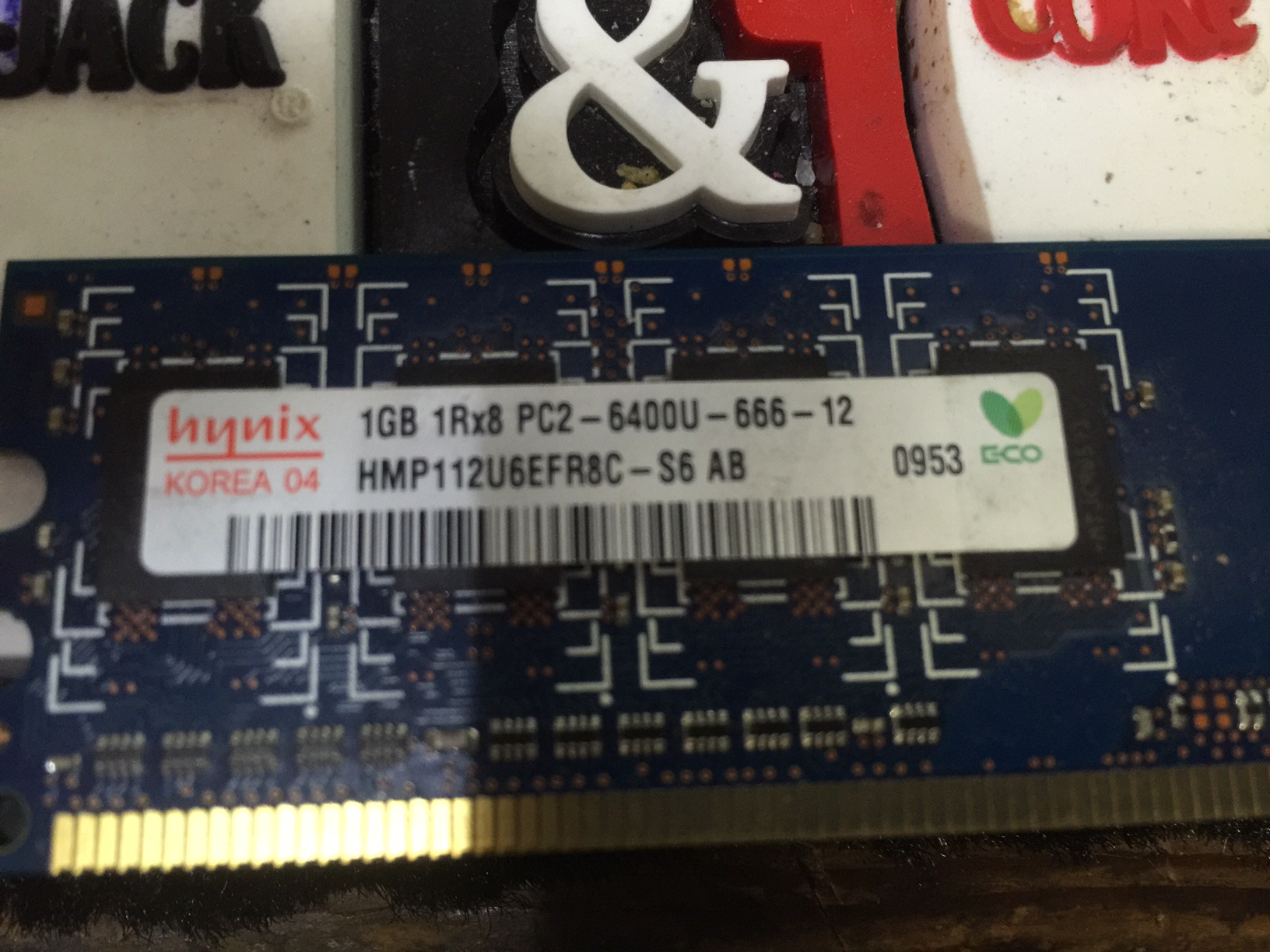

Probably go even cheaper getting a 512 set.
That's handy - I've got a box of 20 sticks of single-sided Samsung 1Gb 1R*8 PC2-6400U-666-12 from PC's works scrapped...
So that's be 2Gb of ram going into my TTX2.

@NathanDrake - That's not correct stuff - you need "PC2-6400U"
E = ECC - for servers or high-end workstations.
R = Registered - for servers.
F = Fully buffered - for servers.
U = Unbuffered. - for normal PC's
S = Sodimm - Laptop memory.
You want - Single sided, Unbuffered, PC2-6400 - the only reason I'm saying single sided is that's what I took out of mine and the slot nearest the CPU has a plastic heat deflector to protect the ram and the chips on the back of that stick would get heated up if I used double-sided.
Look for some ram with a label "1Gb 1Rx8 PC2-6400U" and you'll be fine - it's standard DDR2 desktop memory. I'm using two 1Gb "Samsung M378T2863QZS-CF7" in my TTX2 and it works fine.
most ddr2 ram should be fine single or double sided. just remove the protector if needed.
it just cant be ECC or Buffered.
that ram you posted nathan "should" be fine but like all ram MB comparability can be a real bitch.
Edit: currently im use 4gb of patriot 800mhz ram as i had this lying around and works fine
