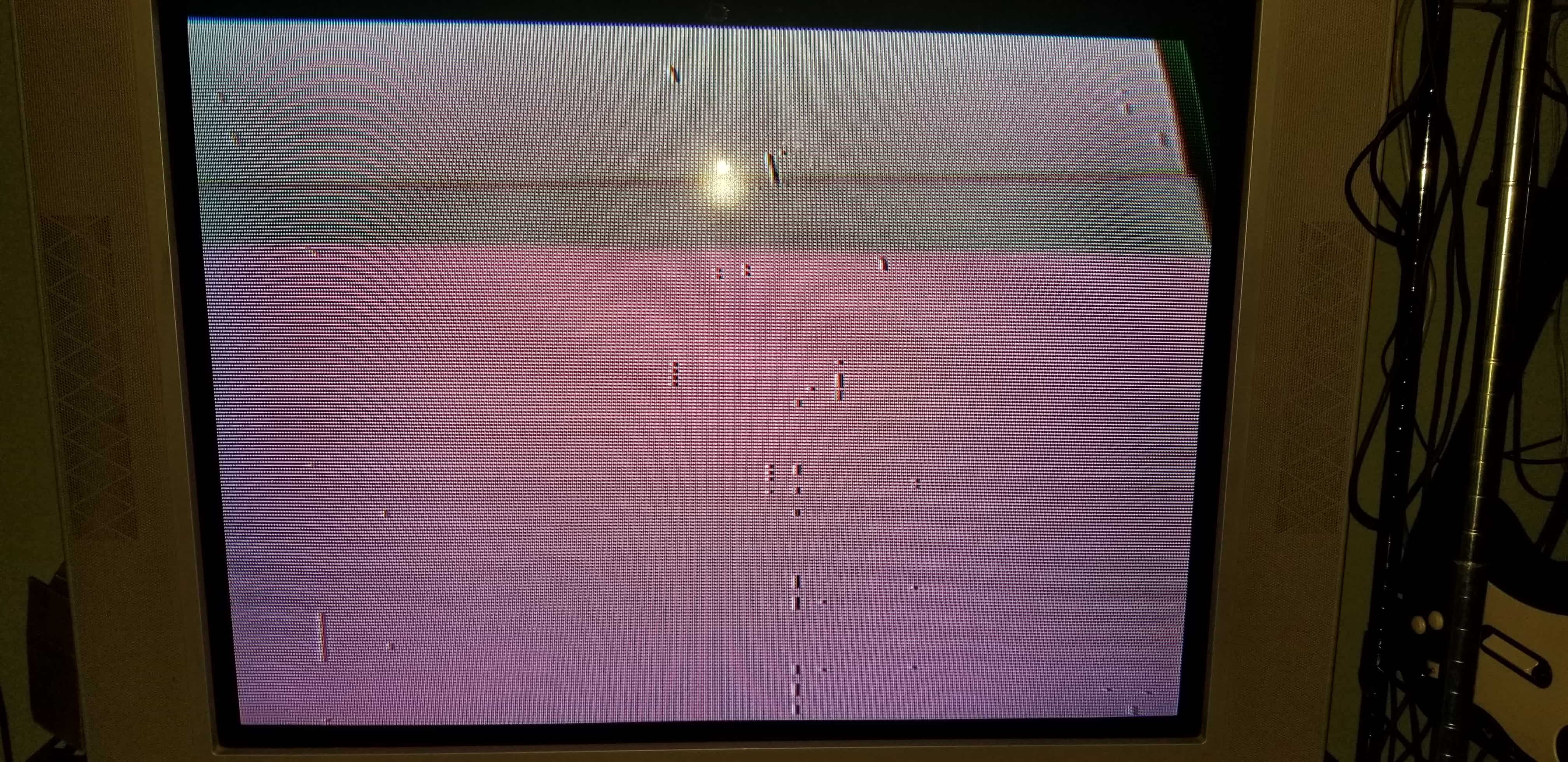

Download the latest Menu (no firmware update is available for the AES yet) put the MENU file into your \UPDATES\MENU folder. The only other folder on the SD card should be GAMES. Cart should boot after 30 secsI don't have a buff file and when I try to boot I get nothing but a weird screen. I've never had the cart working yet. I can't even see the menu yet.
Just checked, it's UPDATE.The instructions say update. I've tried that and I've tried updates.
