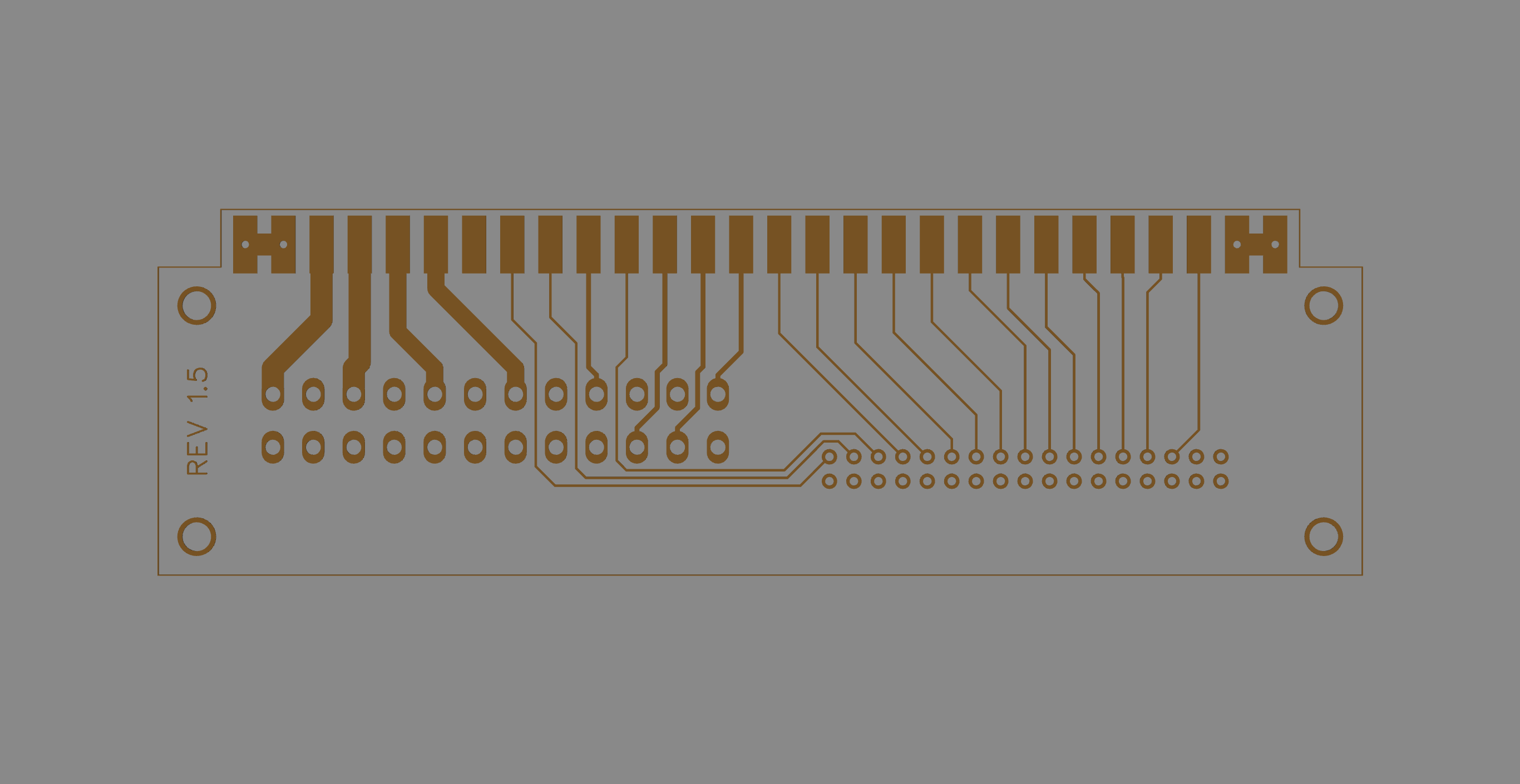

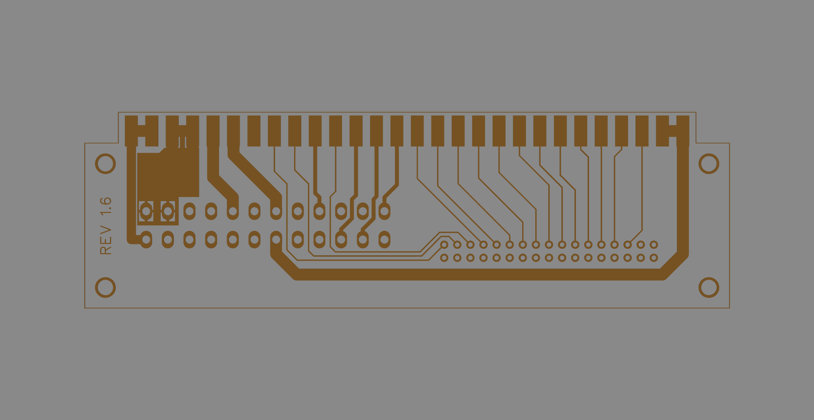

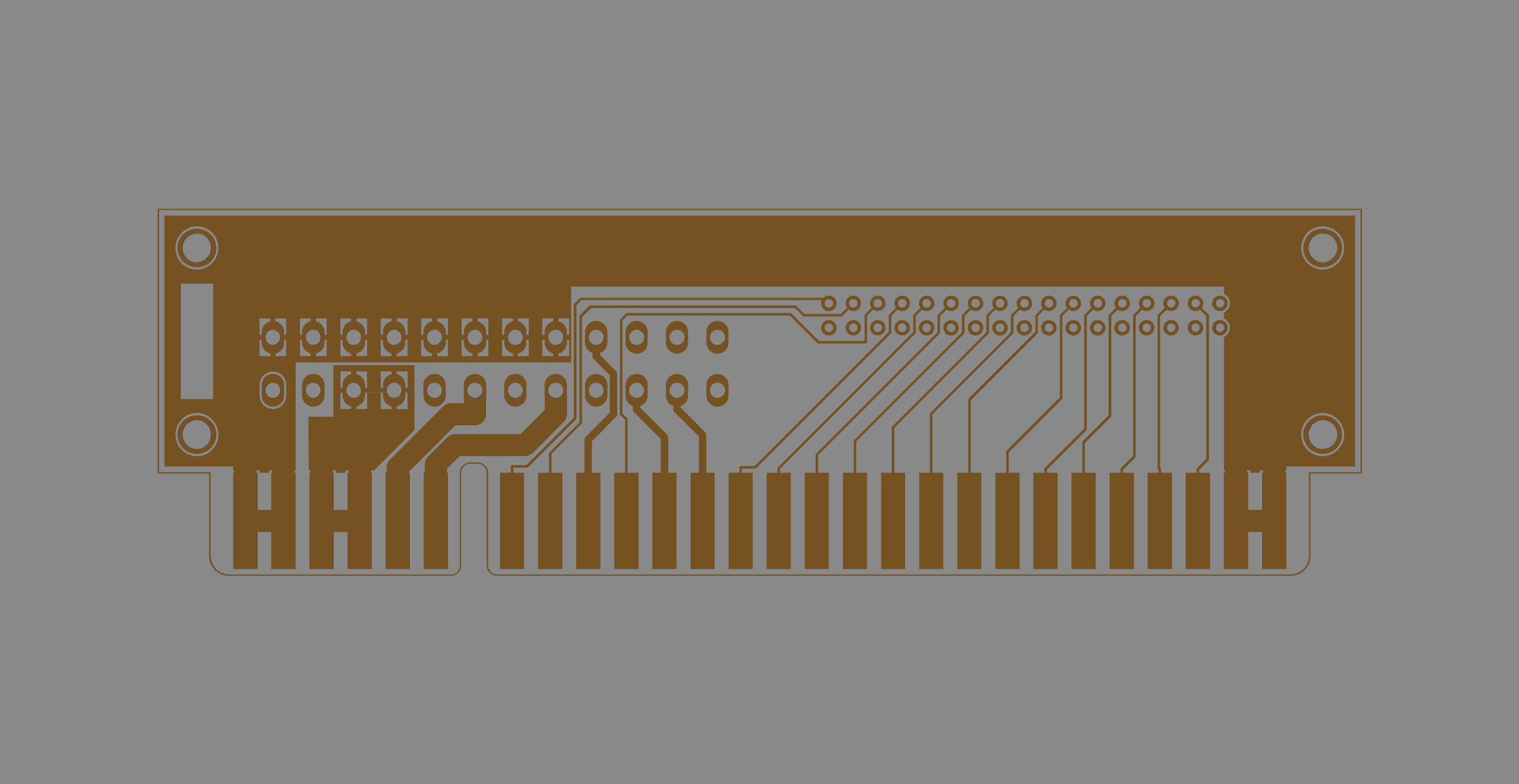

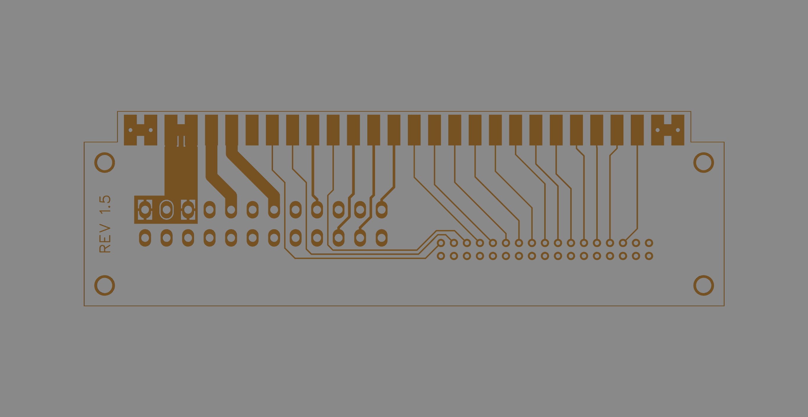

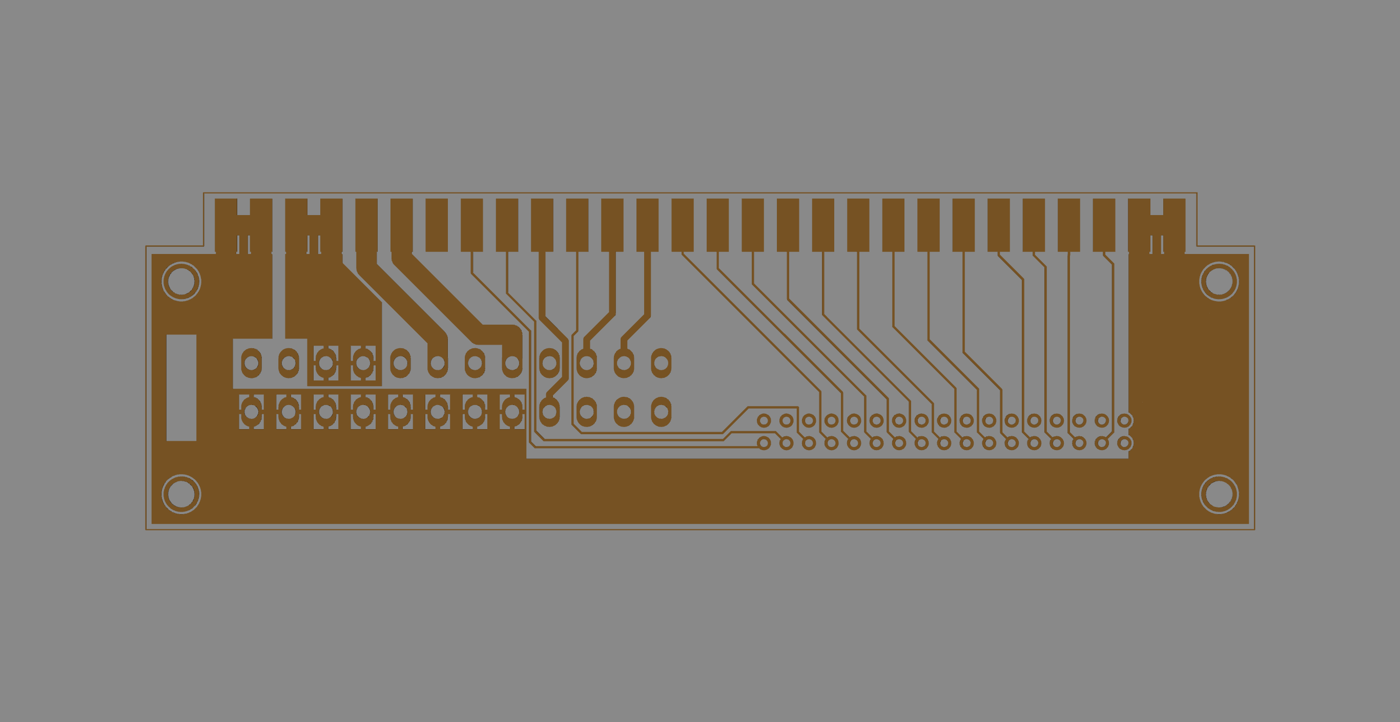

@RGB
90mil for +5V
70mil for +12V and -5V
2.3mm x 3.4mm oval pad for ATX pads.
Anything else you can recommend?
  • Like
Reactions: RGB
Looks good, though I'd move the vias away from the contacts on the PCB that goes into the supergun (in the one shown above it's not a problem, since you're going to solder a JAMMA connector anyway).
The vias on the jamma pins?
They're centred and I'm not sure my pcb software allows them to be repositoned. They're mainly there for the last two pins to tie the top layer to the bottom layer (where the ground plane is).
Yup, the ones on the JAMMA edge contacts. These vias aren't crucial really, since the grounds connect at the ATX connector that is just right above.
I've beefed up power, removed vias and also increased video/audio trace widths. Will give the other PCB the same treatment tomorrow. New version upcoming.
