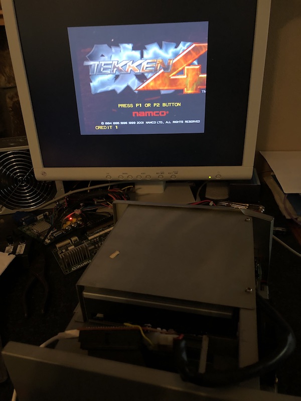

Just received the 246 from Japan, had no idea if it even worked, so just slapped the 2x6 USB Dongle with Tekken4 in there, and loaded up my PCB with the right ISO.
I was told this was the most picky game, and there does seem to be one issue - occasionally, during the intro movie, it'll just go to a white screen. I assume it's the PCB not delivering data fast enough so the game's video player just decides to crap out. If you actually start the game it works fine, though.

From some quick debugging it looks like there's no unimplemented commands/etc., but the game definitely thinks something is wrong. When the screen turns white, it also resets the IDE interface and gives up doing anything.
If I artificially slowed down the software, the game just doesn't play the movie at all, and if I slow it down during the movie, it just aborts playing the movie, so it does seem like there's a legit bug where the board's doing something the game doesn't like (and it's not just speed).
maybe the response to one of the commands is different than what it expects?
these games can be played from a CD-R/DVD-R with the multi-dongle, so maybe record the data stream with a regular drive and compare to your device? would make for a good speed/timing comparison too.
Tekken 4 is DVD but a DVD-R will do the trick.
Exactly what @twistedsymphony said, if you have some way of recording the command and response from a working drive and compare it to your ODE that would be brilliant.
Don't worry - I have a special firmware for the board that turns it into a datalogger so I can see what the drive sent and received from another device on the bus - in this case, I have two of my PCB plugged in via a normal IDE master/slave cable, and I can see that my PCB has reacted weirdly to the 246 transmitting an ordinary ATAPI request ;)
