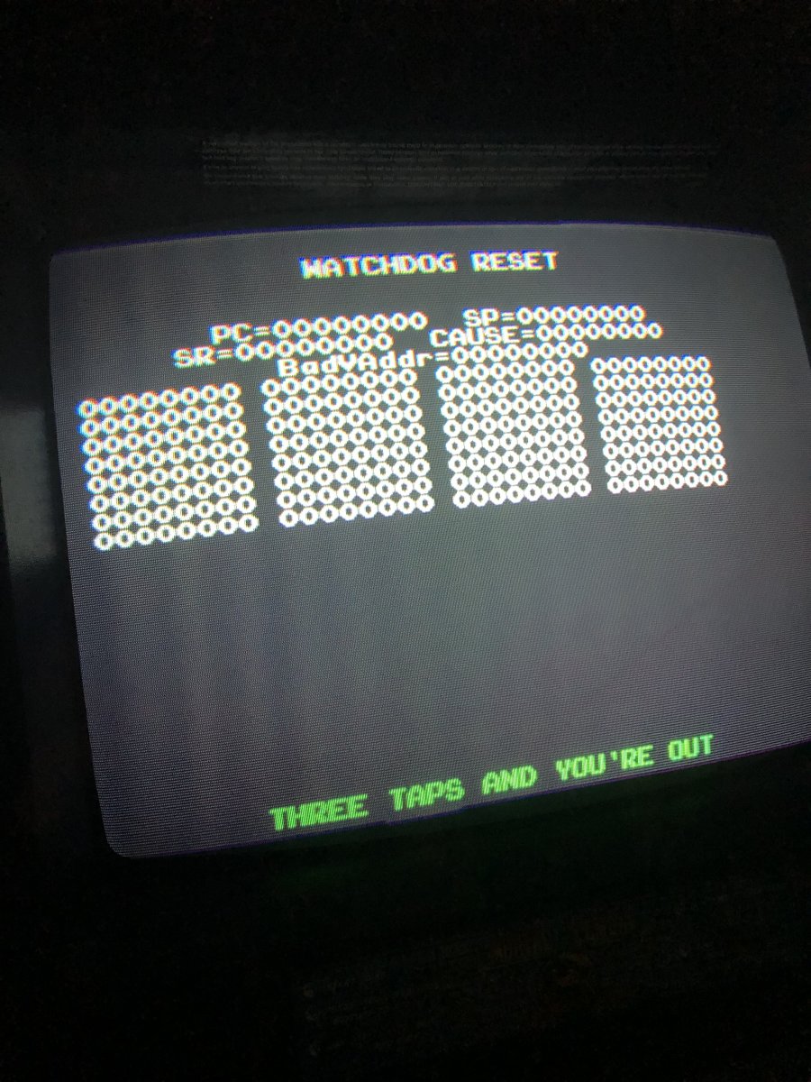

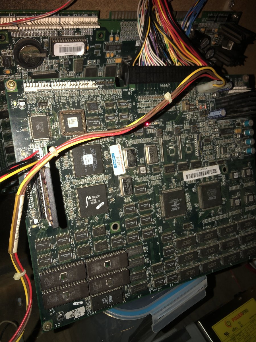

I just got a max force board also and it keeps doing the reset wwtchdog thing but when i see the game the graphics are messed up? I have a new flash card in there but the chips i didnt replace i have the wrong kit..

As soon as I switch on the cabinet, the PWR/RST LED flashes.
The whole image is monochrome and alternates back and forth between red and yellow.
I cannot enter test mode respectively the screen remains red or yellow.
