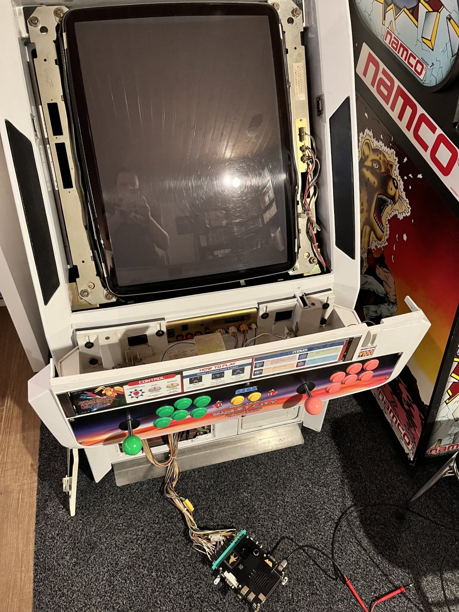

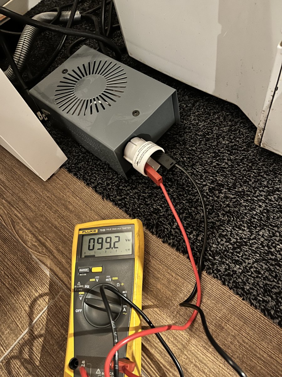

Long story short, between my Blast CIty JAMMA ground, and cabinet ground (cables screwed to the floor) goes 170V AC live, and I would like to fix this.
This whole thing started with MiSTercade remote, since I always got small electric shocks from the remotes metal casing when I touched it and some metal screws from my control panel.

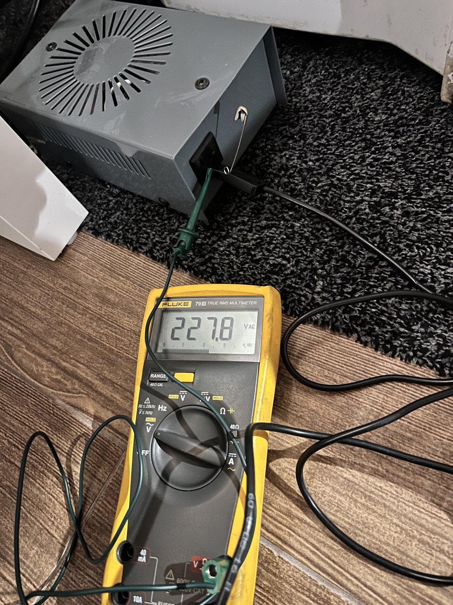

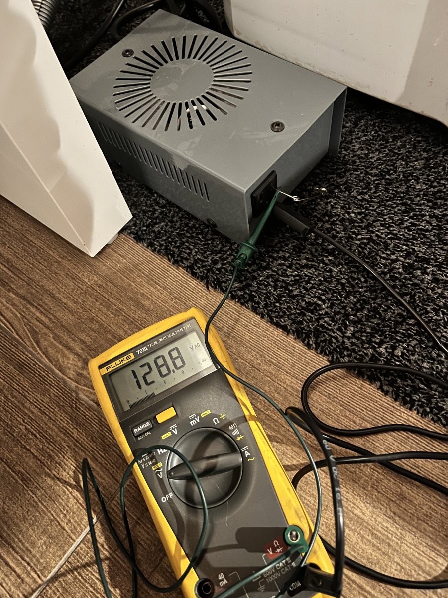

As you can see there is ~170V AC going on between those two, so no wonder

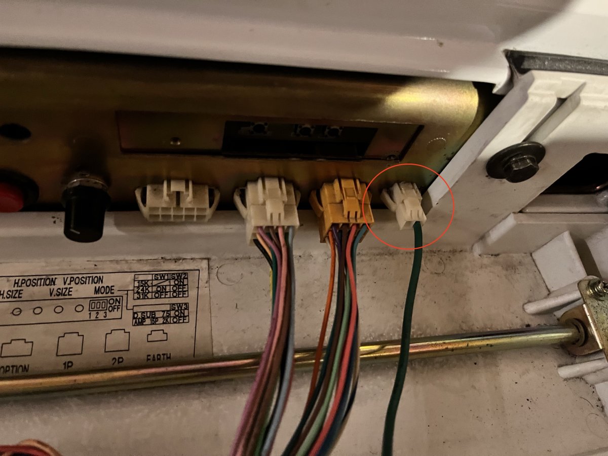

At first I thought that perhaps this is a MiSTercade issue (some more troubleshooting there), but soon enough I found out, that my JAMMA edge ground is not the same as the cabinet floor ground. And not just that but between those two, I have 170V AC going on

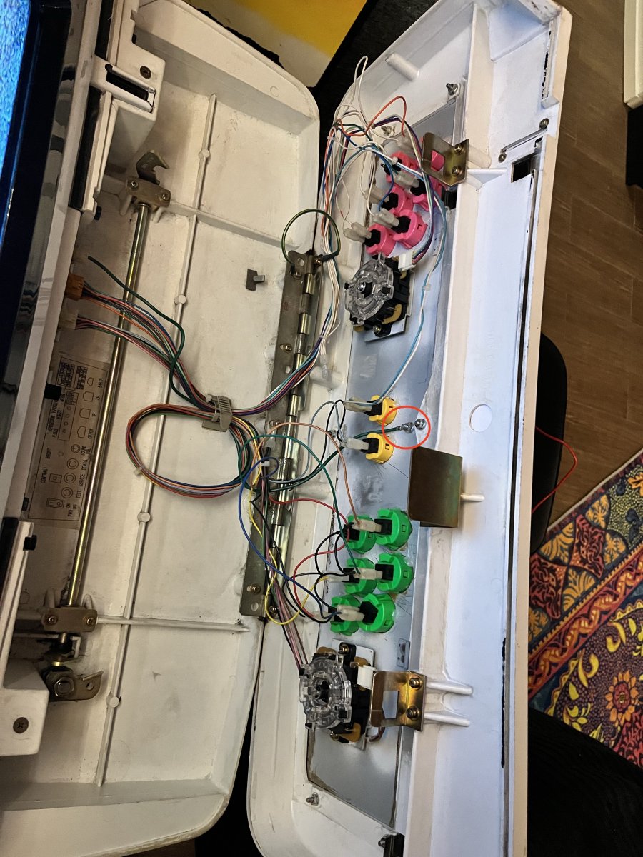

So this ground here at the bottom of my cabinet, which also is connected to my control panels metal plate.

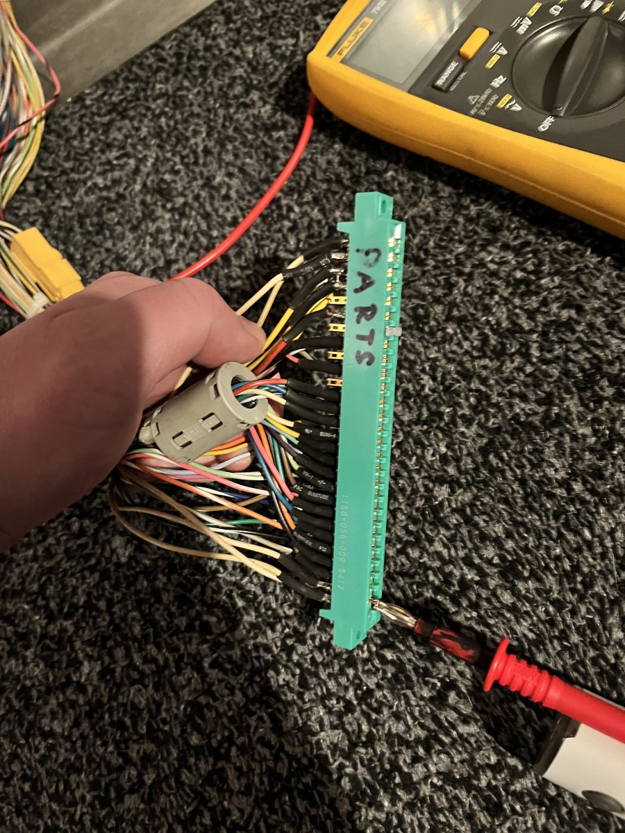

And my JAMMA ground

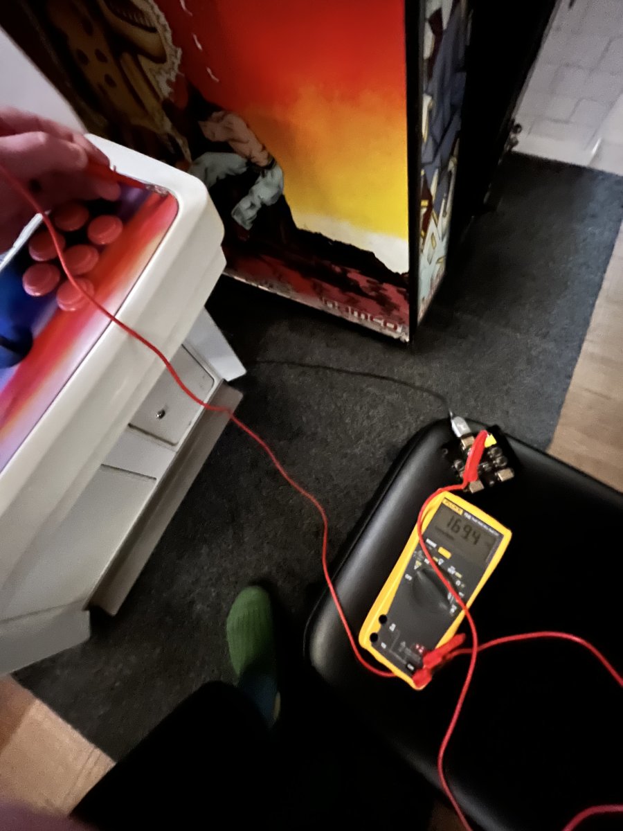

There is live/hot 170AC between those two (when cabinet is on) and no continuity between.
I have changed the JAMMA edge on this one, so could I have fucked it up and put wrong cables on the ground in there or something? And since this is 100v Japanese cabinet, 170V must come from the CRT chassis side right? Any ideas how to start troubleshooting this or where the issue could most likely be?
Everything on the cable management side seems to be in order as far as you can eyeball it.
