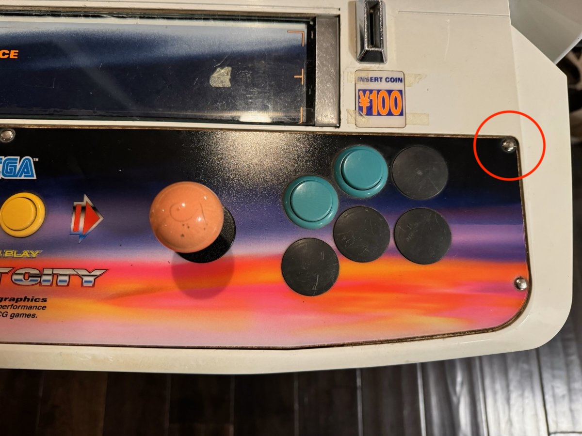

My MiSTercade works just fine, but I have a small issue with the remote. It gives me electric shocks every time I touch remote metal casing and my Blast City control panel metal screws :D
It even reboots the whole MiSTercade if the remote casing touches this screw (and I saw small electric arc between the case and the screw).
Is this remote supposed to ground to the metal casing like this? Can I put some plastic washers there to prevent this?

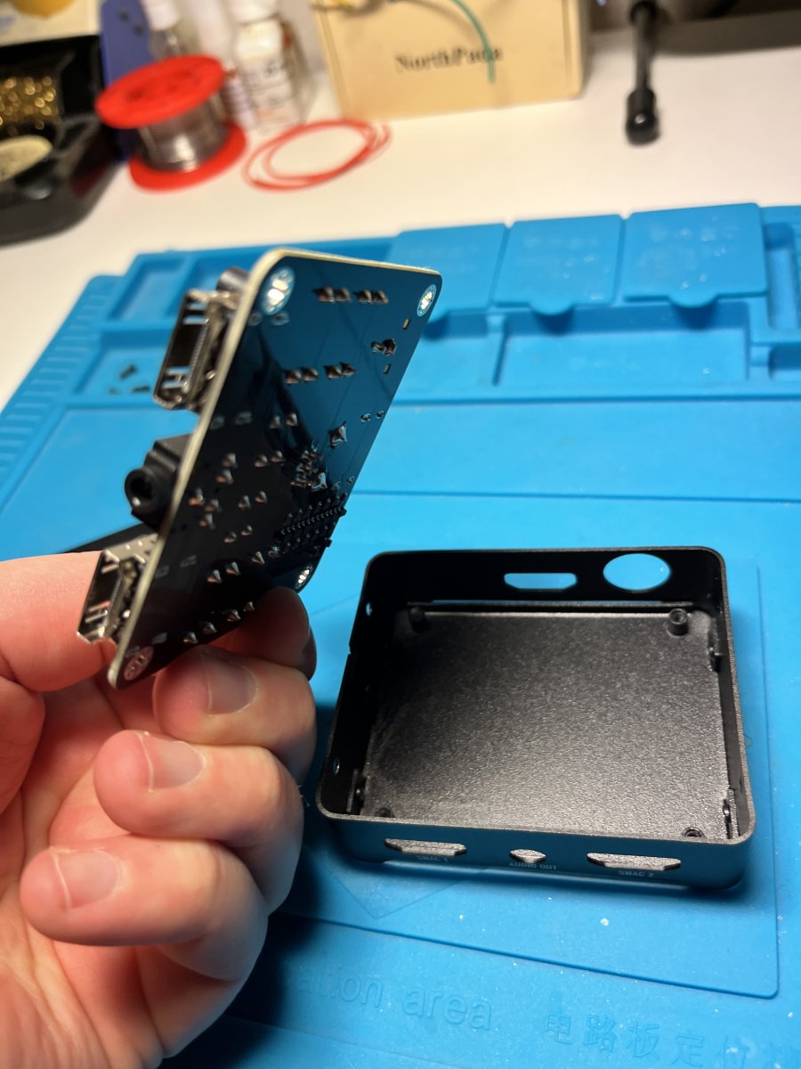

Hmm, that's really strange! I live in a dry climate. The MiSTercade has ESD protection on all pins except for the ground. The remote and case are grounded through the cable which is grounded through the MiSTercade to the cabinet. It definitely will reset the MiSTercade if you plug in the remote while it's running but I haven't had any electrostatic issues otherwise.

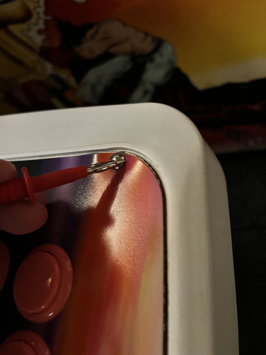

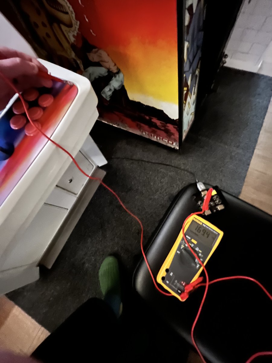

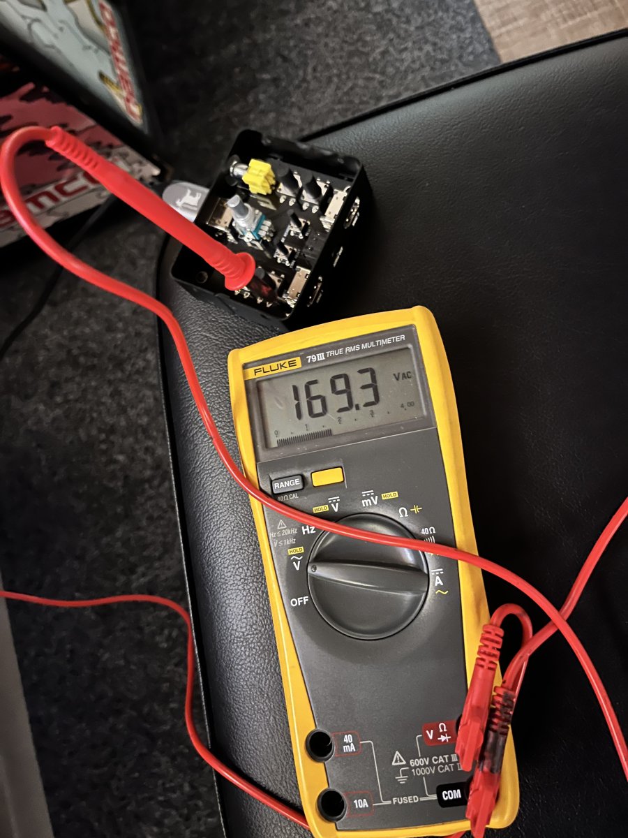

OK so there is definitely something shady going on in here. I measured AC from MiSTercade remote ground to my Blast City screw and there is hot/live going in there.
There is 170V AC running between them, thats why I have been getting shocked :D

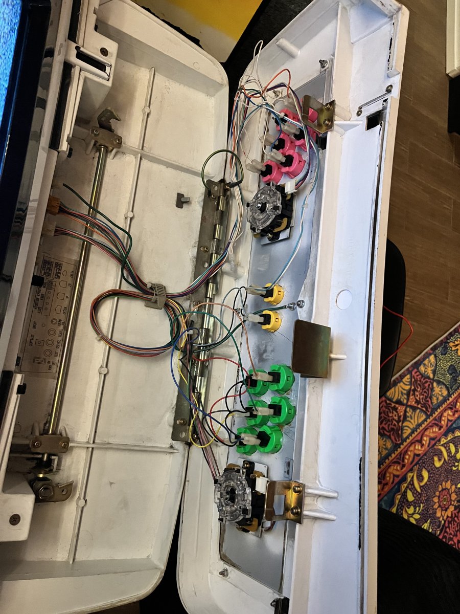

Control panel grounding looks pretty normal to me, any suggestion or ideas how to troubleshoot the problem?
I could test the MiSTercade with my Tekken cabinet to see if the problem is on the MiSTercade side or on my Blast City? Any other ideas?
