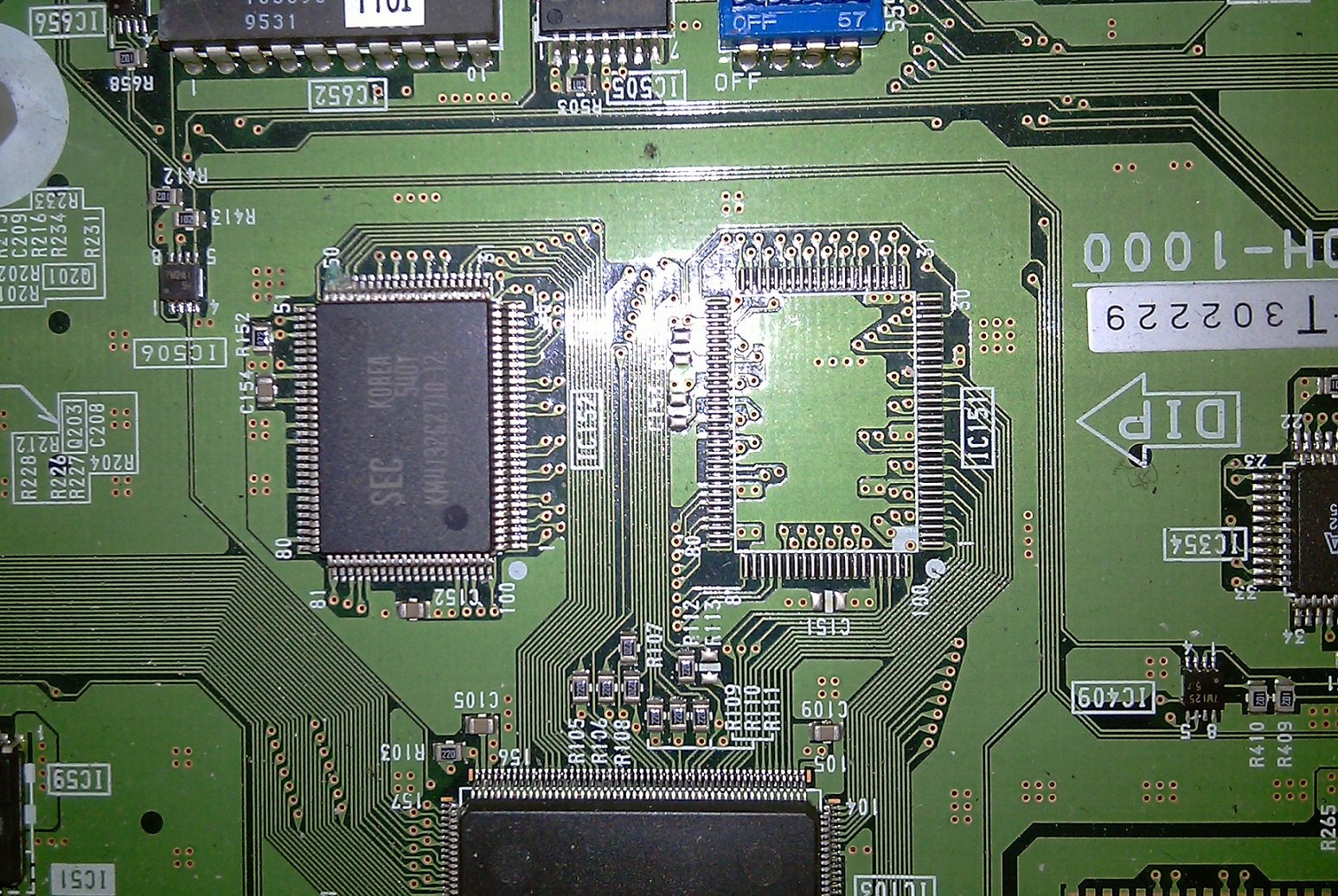

Is see on the ZNx motherboard the space is there to install the ram...
That is the GPU ram, a few games have 1MB but the majority have 2MB. Primal Rage 2 needs 2MB of GPU RAM. You can populate that position and change one of the straps on the board.
But what I was referring to was the CPU RAM. Primal Rage 2 comes with 4 x KM48V2104AT which makes 8MB, but every other ZN1 game shipped with 8 x KM48V514BJ which makes 4MB. So you need to remove all 8 chips, solder in the 4 new ram chips and change the board strap.
ZN2 on the other hand shipped with 2 x KM416V1204BT, so if you can source two of those and change the board strap then you should have 8MB. But the ZN2 runs at a different clock speed & it's not clear what effect that has & it may or may not affect the game. The game dedicates seems to mainly use the extra 4MB for a disk cache, which might not be necessary with compact flash. But how easy it would be to rewrite the game without the source code is another matter.
Excellent information! I have gone over all my motherboards...
Looking at SFEX and Toshinden on the CPzn1, SFEX has more GPU ram.
Was always under the assumption all the ZN motherboards are the same / matched to bios/cat but WRONG!
This adds another level of confusion to the pile!
The SFEX 4mb motherboard is COH-1002C, I also have a COH-1002T on a raystorm. I don't see them listed in the mame driver.
Bios on the 1002C is an oki chip and not the sony mask rom like all my others. If they sound interesting will get some pics / get them dumped.
(makes sense while the B,Roar boot is out for dumping, more testing!)
The motherboard codes COH-1000C and COH1000T are the 2MB gpu ram versions of the same pcb's,
Ram swap looks fairly simple just a case of working out the jumpers. As you say, the donor game might as well be a 4mb GPU game to save time.
