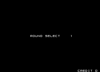

Also a level select code, to check the levels:
Level Select
This game uses the Taito Code:
  1. Hold the Service Coin button upon booting, and wait until a "SERVICE SWITCH ERROR" message pops up on the screen.
  2. Press 1P Start (x3), Service Coin, then 1P Start again.
Upon this, the player is redirected to a stage select menu, which can be navigated by using 1P Analog.

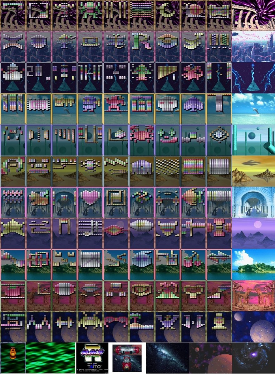

To use the tiled backgrounds from Arkanoid would require to convert the bitmapformat and the palette to the one Arkanoid Returns use, or recreate the backgrounds. But that would require to write some tools for it first, so it would be a quite time cunsuming task. To prevent the backgrounds to be displayed (a black background) would be an easier and faster thing to do.
Yes, digitized graphics was popular around that time, Same with the early Amiga games. Was probably a fast and cheap way to get the games out as fast as possible on the new hardware. But most of the time the end result became ugly and uninspiring.

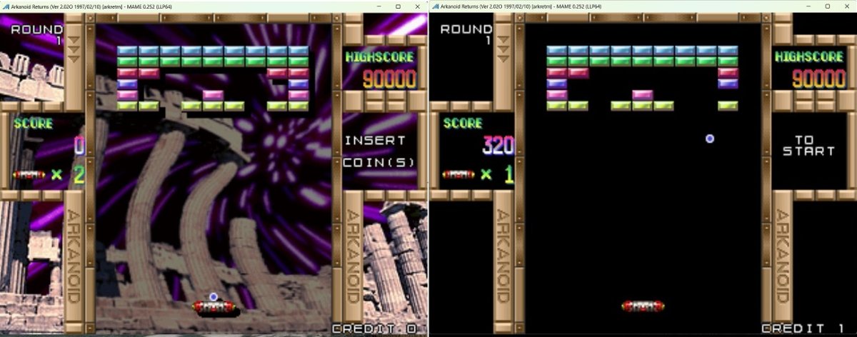

That screenshot is not made my be, I found them online. The pictures to the right in the previous post shows how the original backgrounds looked like. But of some reason they decided to apply a "filter" to make the backgrounds more darkened and blurry. As you can see when you compare the smaller pictures in the corners of the screen. I don't understand why the made that choice since the backgrounds looks so much better without that filter effect...

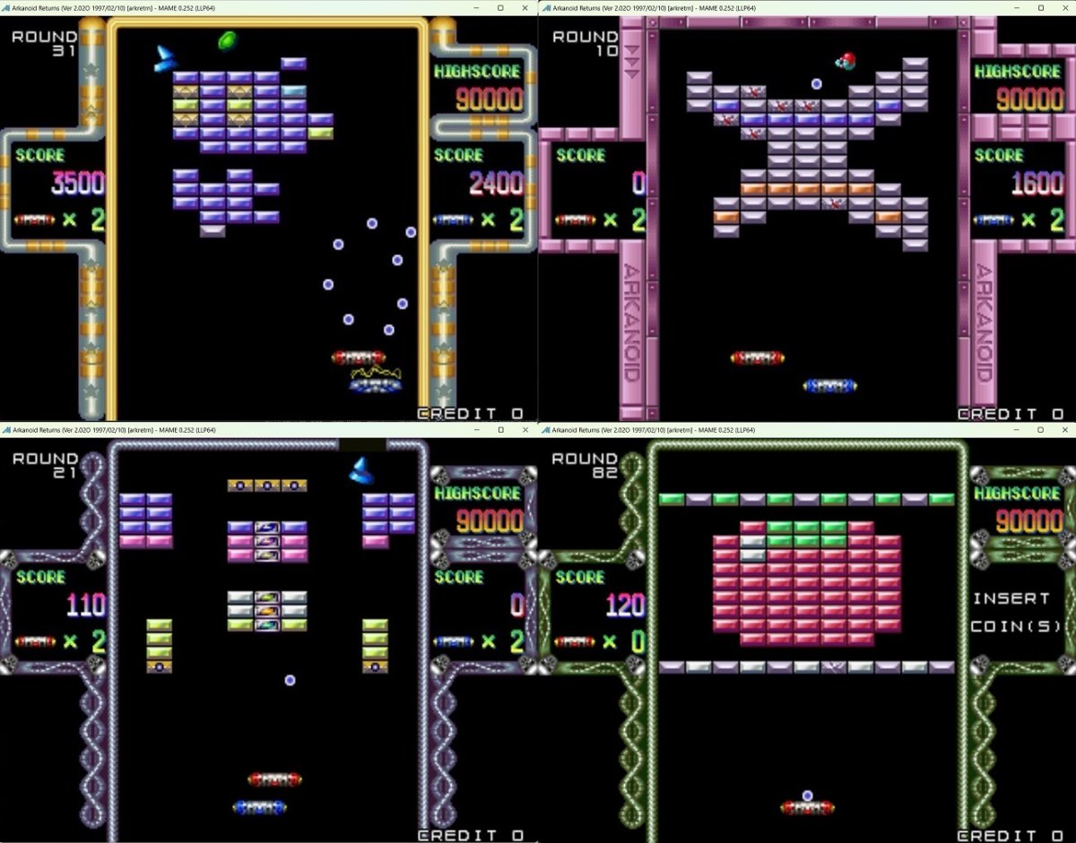

Anyway, I did a test by removing the background last night, to see how it would look like... The backgrounds are tiled, so It should in theory be quite easy to replace them. But that would require some tool or editor to convert the ones from the Original Arkanoid...
Nice work @Pythagoras !
I was a bit too curious last night and broke out the old code. TAITO changed the format around a bit. Currently I have a generator which removes nearly all the backgrounds.
There are fewer background images in Arkanoid Returns than in Memories so this might not take too long.
As for injecting the old backgrounds into Arkanoid Returns that should be possible but you would need to convert the images to the F3 tiledata format.
Too bad we don't have a graphics/tile converter. Have tried tile molester before but that doesn't work on W11. It had been cool to be able to make a setting where you could select the background tiles to use; Arkanoid, Revenge Of Doh or Arkanoid Returns.
