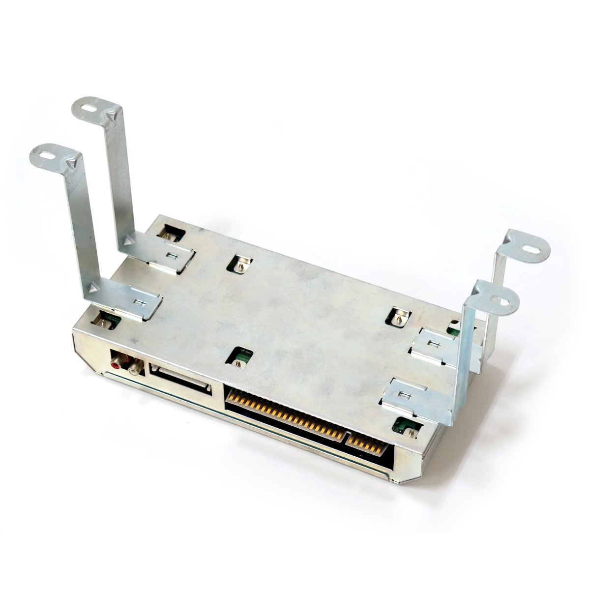

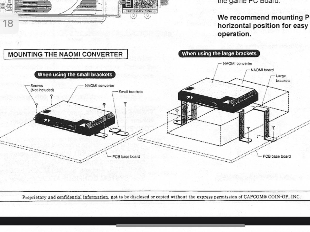

They’re for mounting over the NAOMI motherboard.I’ve never seen those type! I’ve only seen the “flat” style. What’s the extra height for? Would this sit over the Sun PSU?
Yeah that’s my plan if I can’t the original/reproduction set or a more elegant solution.another option would be to use the regular style flat feet... and then just use some wood or angle irons or something to create stilts.

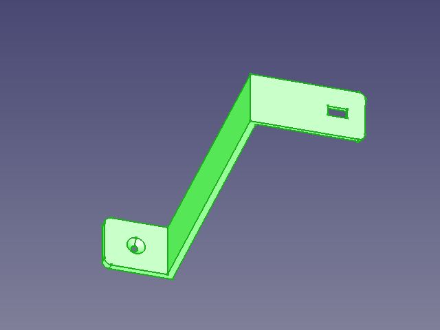

Wow, this is fantastic. Thanks so much for taking the time to model and test.EDIT: So I modeled this. It's 125mm tall and it should clear a Naomi with a Netdimm on it. I test printed a stumpy one and it came out fine. I modeled the width and cutout based on CPS2 feet, I want to say they're compatible?
Remember to print with supports, so the square cut out doesn't deform.
Not being experienced with 3D printing, what’s the recommended material?
I don’t have a printer so I’ll wait. Thanks again!I printed mine with just regular PLA. It looks flimsy, but it's surprisingly strong. If you don't have your own printer, maybe wait for someone to confirm that it's actually the correct size. I don't have a Capcom IO here to test it out unfortunately.

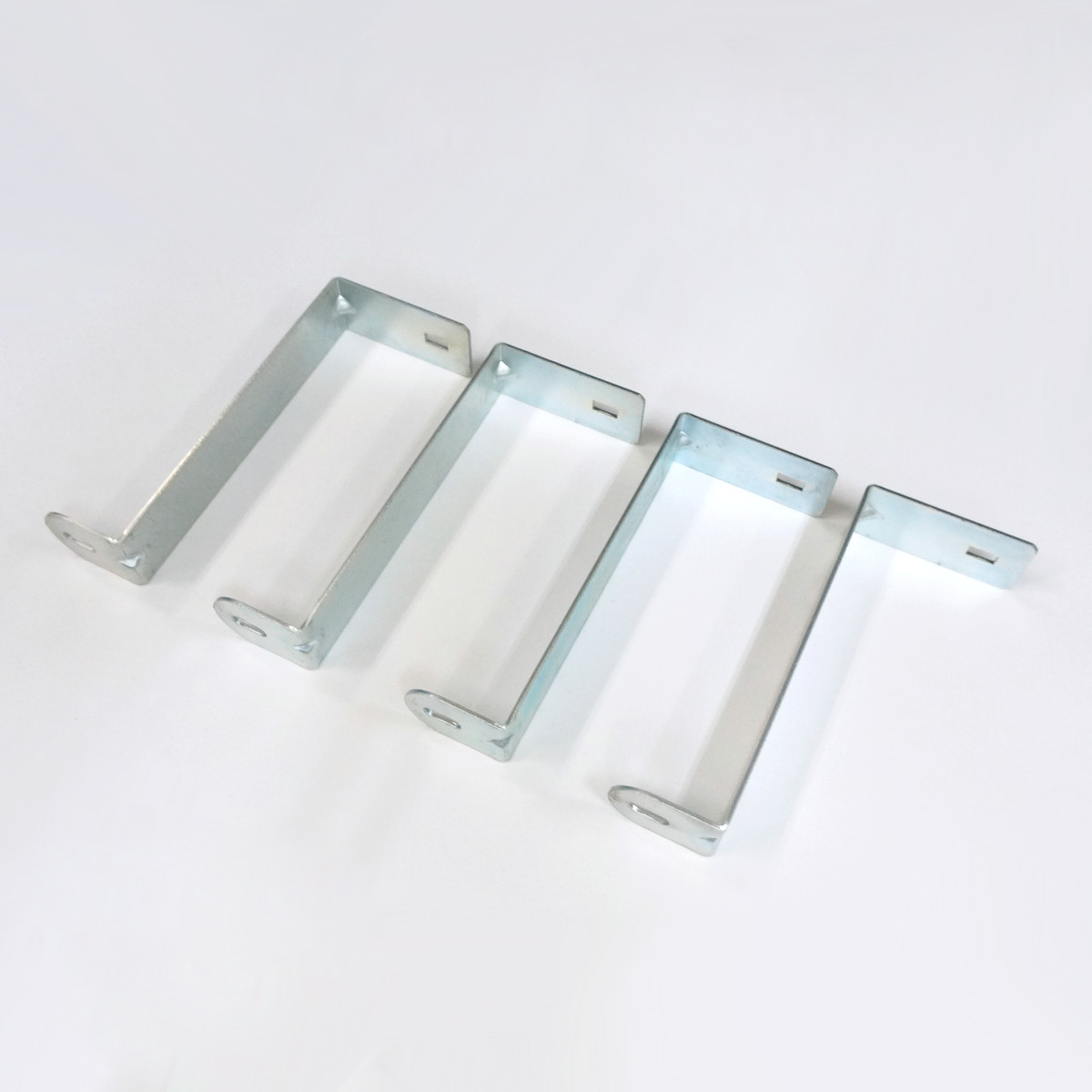

I printed up the mounts.
