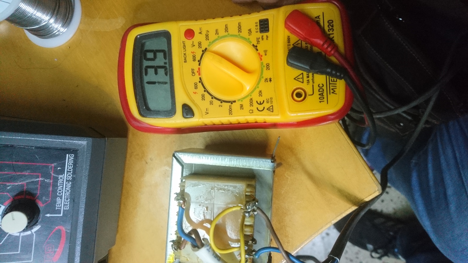

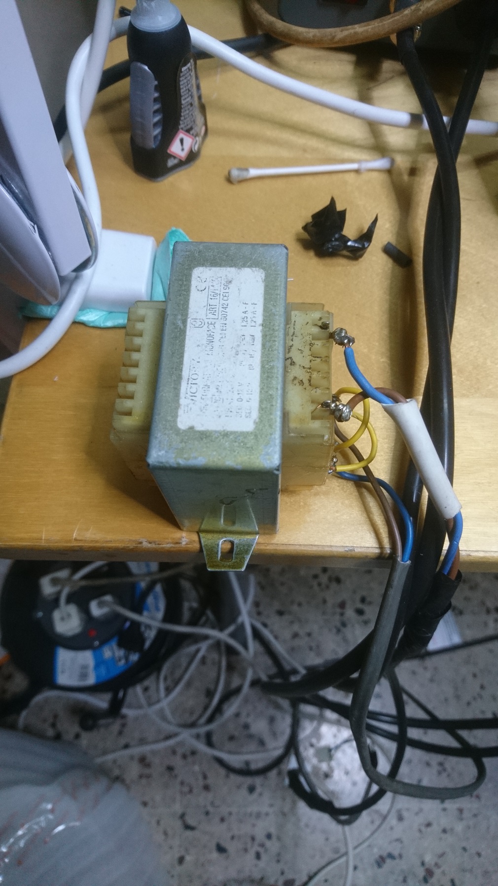

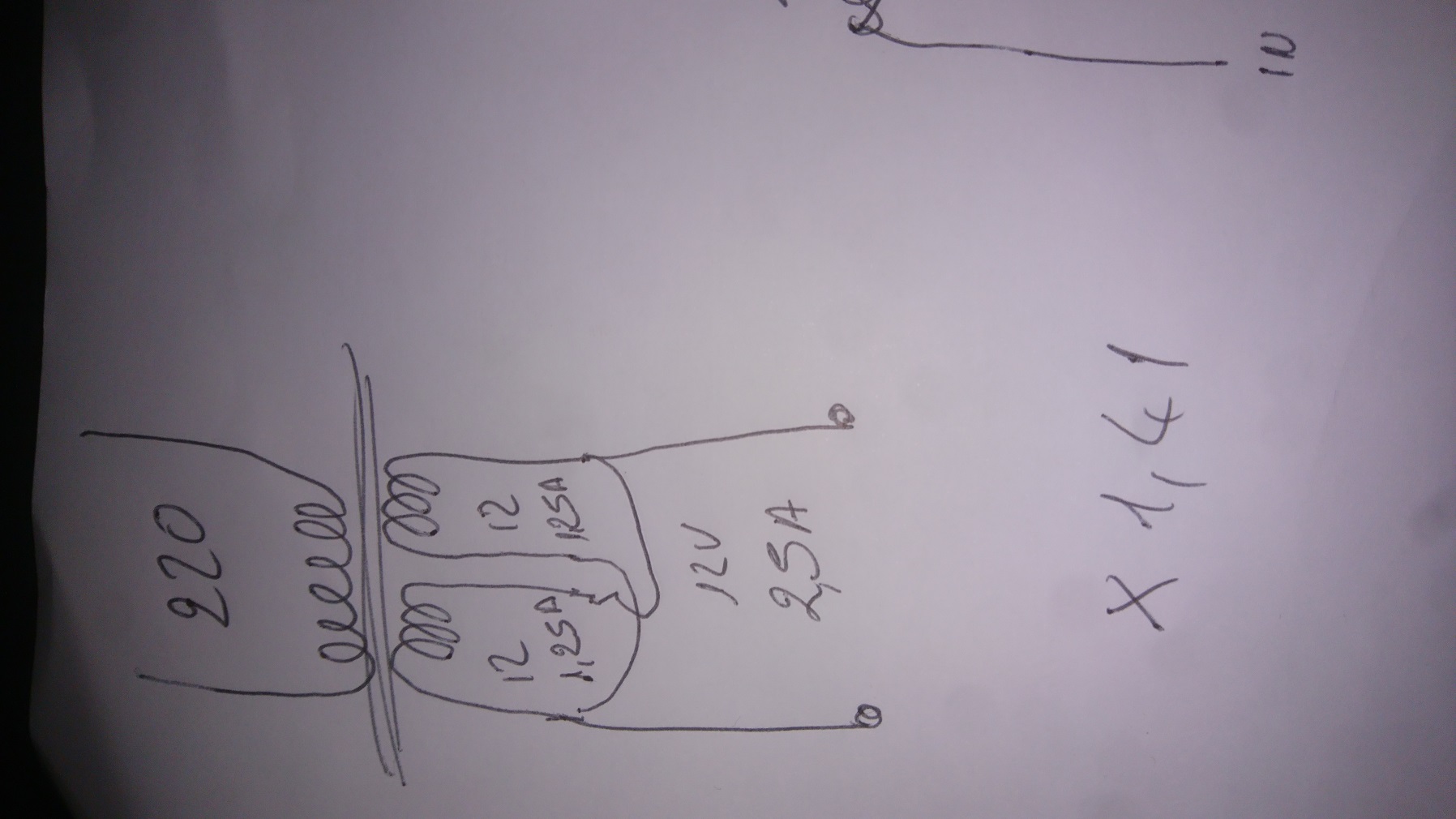

On the capcom amp there are not Ics for qsound decoding because they are on game pcb only, the capcom amp is still a good amp pleanty of power and use Elna Duralex II high quality audio caps so it is a very good amp and match just perfect with capcom q games, as I said before it is basically 12v 2.5amp minimum the 18v are only a legend. Classic old games + classic old Crt 15Kz CGA RGB monitor+ classic old power amp is just a perfect union! I must say that the naomi amp wich is very similar but not offer the same sound with capcom q games so there is really something special..
without 2.5A it will not start up for sure, here is the schme and the trasformer I have builded for the Q amp, and it works flawlessly exactly like the original one. It only cost abou 3€ ;)
Now I'm going to build an external volum pot, every one for channel ...I will use the amp with jamma pcbs and my 20" PVMs monitors...they are all mono and have the worst speacker ever made..

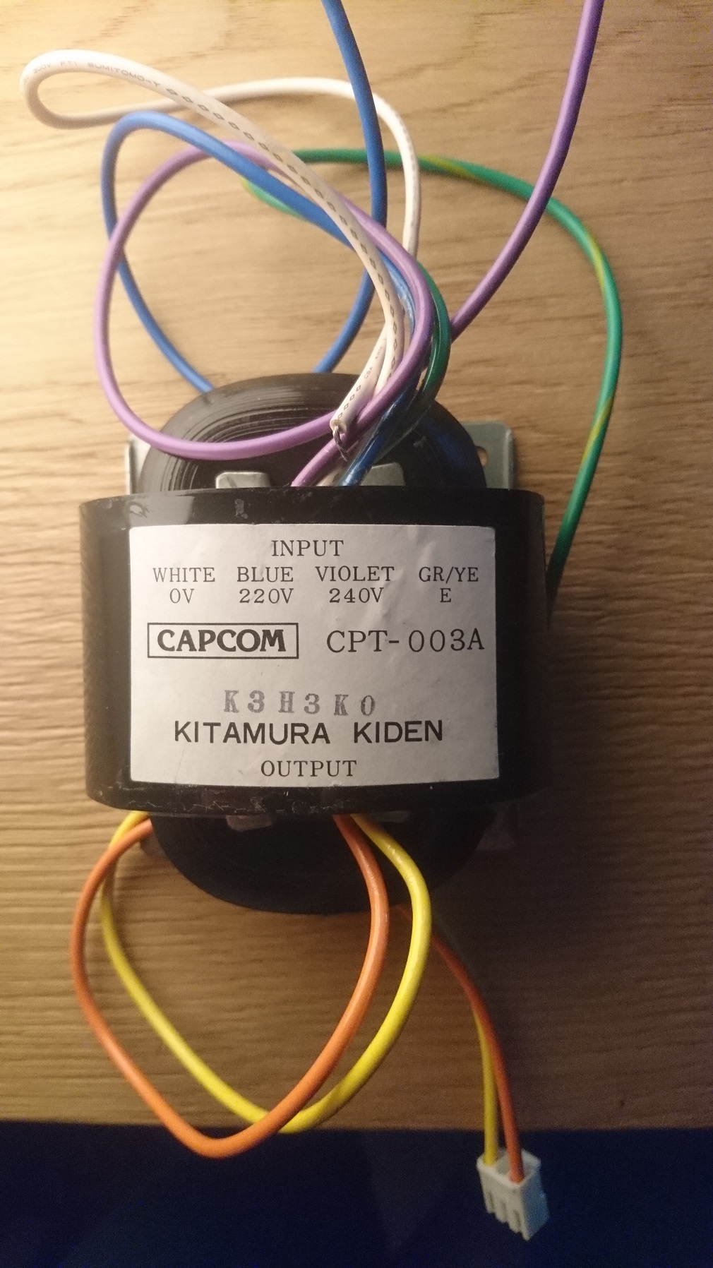

finally I forgot to mention the CPT-003A model which was distributed here in Italy in 1996 in a few pieces, this version I think quite rare accepts 220v and 240v I never tested it, but it was present in my kit of Red Earth Eu
