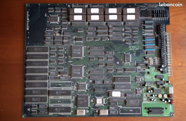

I played this game only with the JAMMA port through a Supergun.What’s the connector to the right of the JAMMA?
All Namco Games from this Era have this connector on it, it's similar to a CPS2 kick connector in that it's uses for kicks, or 3-4Players, and some other functions.What’s the connector to the right of the JAMMA?
I call it the NAMMA edgeAll Namco Games from this Era have this connector on it, it's similar to a CPS2 kick connector in that it's uses for kicks, or 3-4Players, and some other functions.
I've documented it's use here: https://docs.google.com/spreadsheets/d/1m65U5LoPNUG947p6M_ww1GXizrQHMAo-Dtzjif1oGg8/edit?usp=sharing
Outfoxies doesn't really use it except for a 2nd audio output.
Awesome. Thanks for the info. Learn something new everyday!All Namco Games from this Era have this connector on it, it's similar to a CPS2 kick connector in that it's uses for kicks, or 3-4Players, and some other functions.
