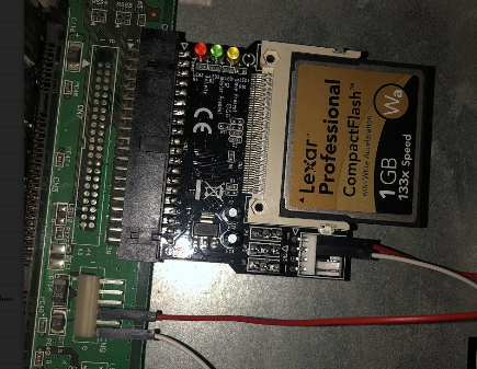

Was fairly straight forward... jumper had to be changed to netboot the latest Chihiro type3 firmware, but then changed it back to gd-rom to use CF.
1st adapter did not work, but the one in the pic works great. I'm using this setup in my OR2 twin cabs, so I did have to re-encrypt the game to the specific OR2 key before writing it to CF and then rename the boot file on the CF to the correct name my OR2 key is looking for.

Oh, that's interesting. If you ever want to write a short tutorial on how to do that, I would certainly appreciate it. Like what you use to re-encrypt the game file and how you find out the boot file the original key is looking for.
I have a pair of F-Zeros I have booting from CF, but I'm using decrypted game files and zero keys.

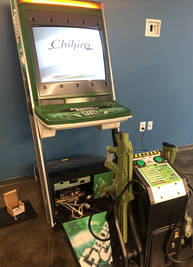

I can probably put something together. I actually am in the middle of converting my Ghost Squad UR to run off CF, so will try and take pics and document it!
And yes, one of the guns was left upside down.... kids :P
