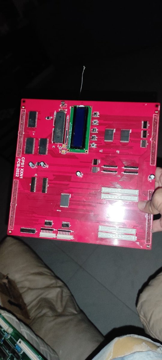

arrived for me today. the pcb has graphical errors and the weak kick on the left side is triggering randomly. does anyone know what the problem is?
I managed to solve the problem by resoldering pbb B and replacing two components as shown in the attached photo. Pcb apart fully functional

Ah ok lol, the B board lol,
You have changed or just replace the 2 in the circle ?
My reading is that they reflowed the solder, leaving the current component in place but ensuring that it is properly soldered down by using some flux and heating up the pins. The capillary effect will pull the pins into place and pull the solder up onto them.

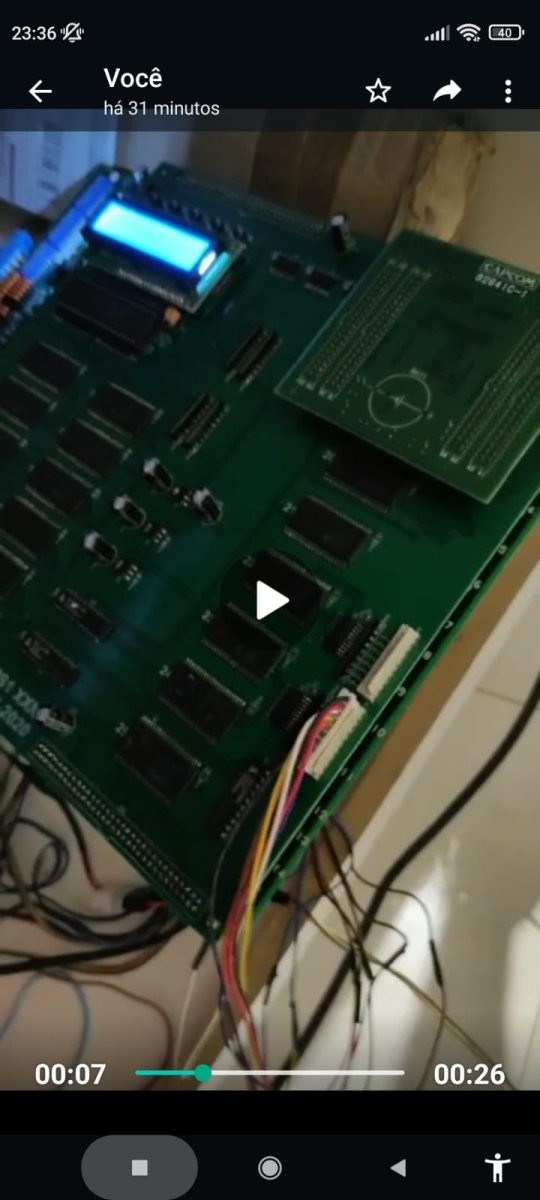

I have this Chinese multi cps1 with 87 games. Most games are working perfectly. Some games are already showing graphics failures. What could be the problem?
