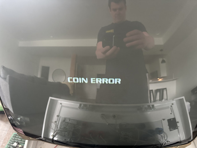

I trying to test "Ranger Mission" I received from @sheep_nova on my Atomiswaves connected to my cab.
It just boots to Coin error over and over again on an infinite bootloop.

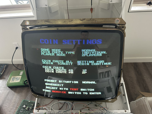

I hit service button and made it into the options. First I set the game to Freeplay and then changed the coin type from normal to single coin 2 player.
Nothing I do makes the error go away.

Does anyone know how to make it go away?
EDIT: *SOLVED (moved coin black wire from right to center prong under mech.)
