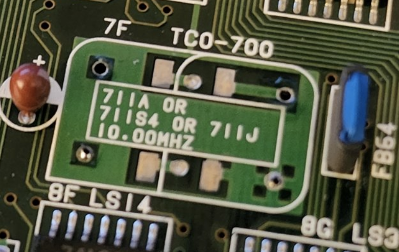

When you remove the current crystal you can actually see where they designed it to use different packages of the crystal.
to those that have their donor boards and dont mind unsoldering their crystal can you check if underneath it looks like this?
Trying to see if they are all like this, I've had reports that some only have the Dip14 package pins
Obviously we are looking at these 2 boards
I think I found compatible smd crystals to replace the current Dip14 ones you see in the pics.
Do you mean the SMD pads or just the extra pair of holes to accommodate a square package crystal?
This is the 10mhz short board.
Trying to see if the are all like this
The 10mhz short board is confirmed, so my guess is that all the 10mhz short boards are like this. Now just need to verify if the 12mhz dash boards are like this as well.

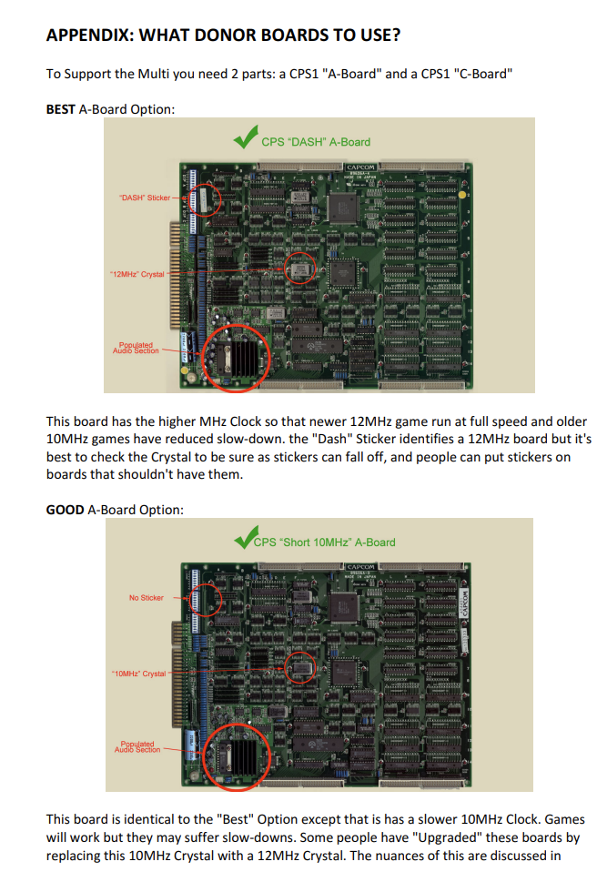

IIRC there are 2 revisions of the short A-Board. CPS-Dash and CPS-Q-Sound are all the later revision, and the 10MHz boards are mixed between the earlier and later revisions.
you will want to get the PCB# silk-screened on the board to determine if they "all" are like this.
89626A-3 (Short board) almost always 10MHz (AFAIK)
89626A-4 (Short board) Could be anything, used for 10MHz, CPS Dash and CPS Q-Sound
There are 4 other A-Board PCB variants AFAIK but they're all Long-Boards

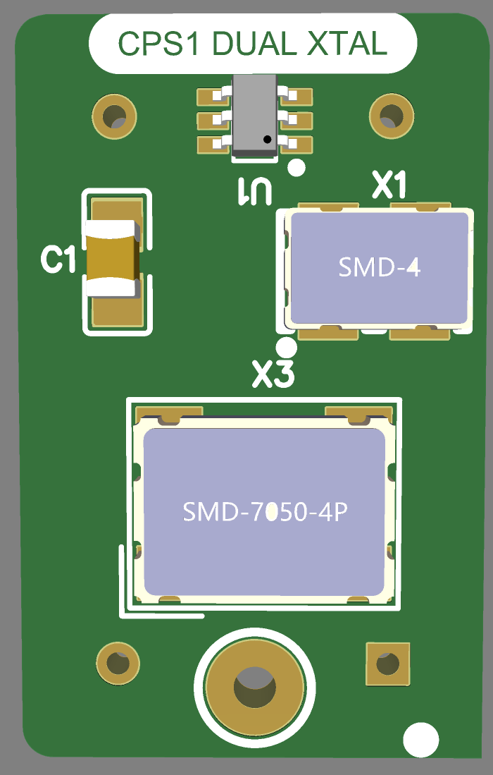

Here you go bossman :D
Its gonna look something like this:
Getting the right crystals spec wise is the problem really.
But with this layout it will drop right into the current crystal posistion.
