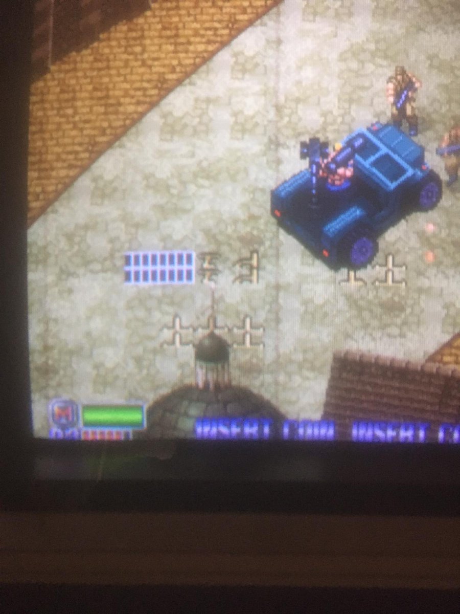

There were some small graphic glitches in this game. They were some sprite not mapped properly and showing up where they shouldnt. See picture.

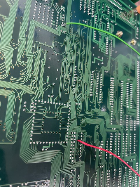

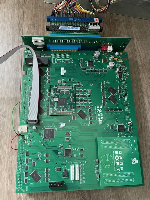

Finally have time to install the Multi I bought in September 2023!
Installed everything per instructions:
  • A board 89626A-4 - tested working A/V with Carrier Airwing
  • C board is the reproduction from Darksoft
  • No FW update performed on the Multi (assumed the latest was already on it)
  • Replaced the PAL on the A-board
  • Soldered the 2 wires (see picture, I'm not a native solderer 😅)
  • All DIPs are switched off on the A-board
  • Jamma loom confirmed working with other PCB's
  • All Jamma edges/connectors with the filterboard are aligned
  • dot_clean'd the SDcard
  • First game flashed is VARTH - both lights green. Once written, 1 light green.
Resulting in this:
(the sound in the beginning of the video is from elsewhere in the room)
Looks like the game is running, but only with Red color and I don't hear sound (I left the volume knob the same from the Carrier Airwing test).
I reinserted the filter board, pressed carefully all board connectors again. Same result.
Rechecked the Jamma loom with another PCB, that works fine.
What could I have missed? And what can I try?

Does Carrier Airwing work when flashed?
Is this issue only related to Varth or other games also?
Do you by chance have another CPS-1 A-Board handy?
If you could try alternate ROM sets / SD cards (if available) that would also help early diagnosis.
