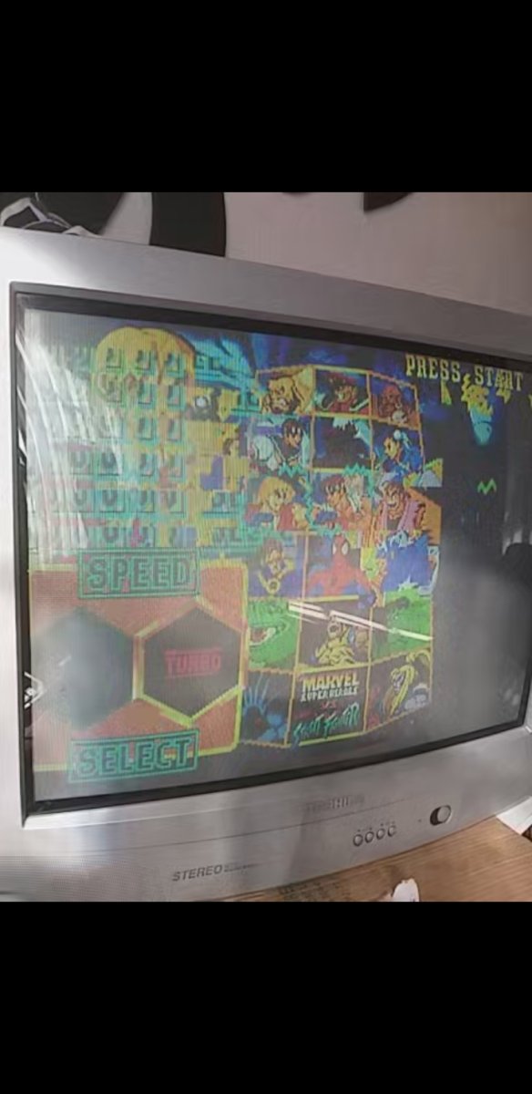

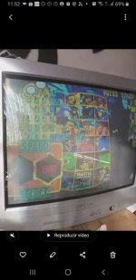

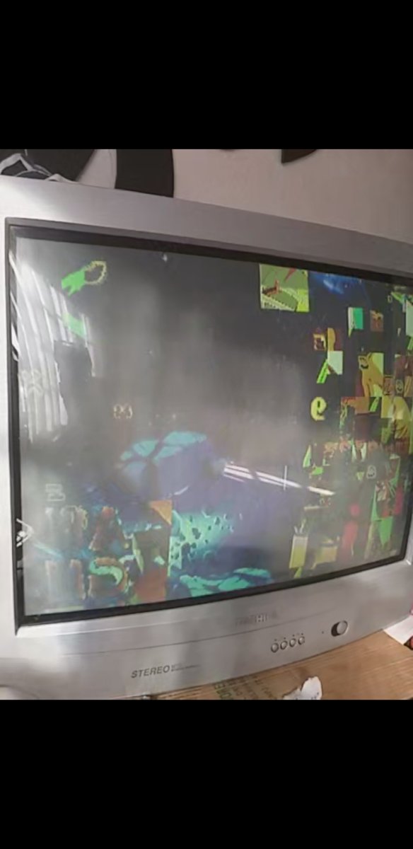

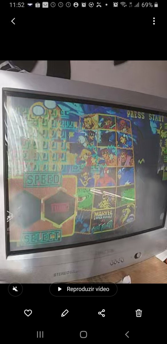

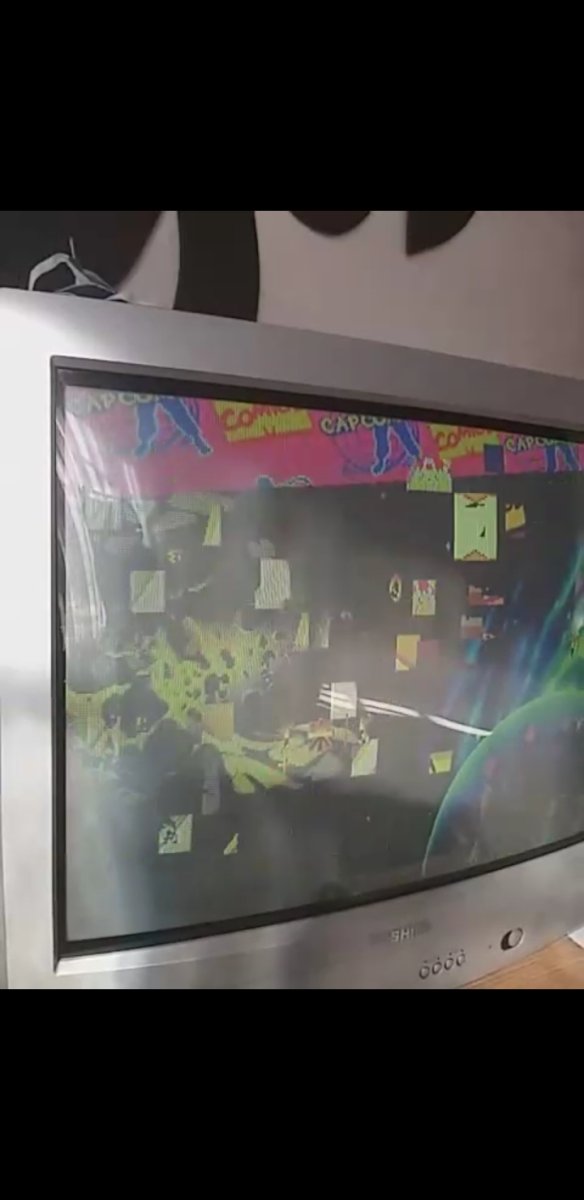

Hello, could anyone help me? I have a B board with a graphics error, as shown in the video. I've already done some tests, like testing other roms and maskroms, changing PAL's. I tested with the rom tester and there was no error.
Simple answer first: a poor connection between A and B boards can cause CPS-2 graphics errors. Make sure there’s a good connection between boards, e.g. ensure there’s no gap and use the case clips. Try cleaning the connectors; Deoxit works wonders.
Resposta simples primeiro: uma conexão ruim entre as placas A e B pode causar erros gráficos no CPS-2. Certifique-se de que haja uma boa conexão entre as placas, por exemplo, certifique-se de que não haja folga e use os clipes da caixa. Tente limpar os conectores; Deoxit faz maravilhas.
