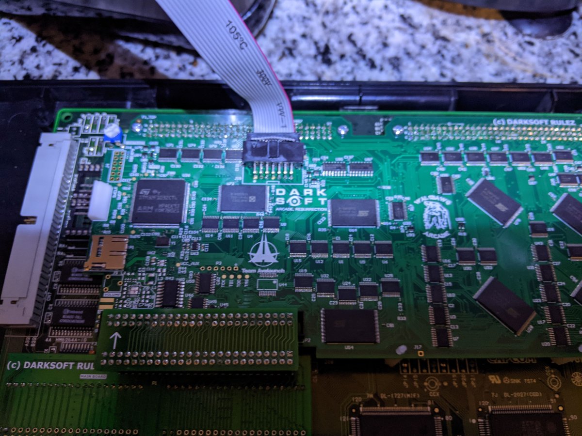

Also try using some pressure underneath the small interconnect PCB and the multi boards to push it into place. Ensure a snug and flat fit for all three boards and definitely make sure your CPS-2 A/B are very firmly connected.
Your picture 20210427_194006.jpg. Can you pull from the multi PCB up a bit towards the interconnect PCB. Are you sure that they make proper contact?

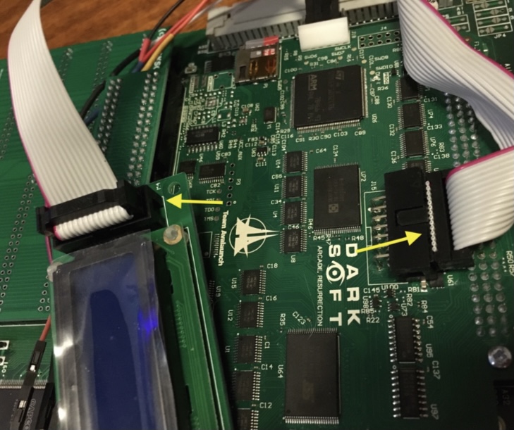

You may be right about the cable... the fed-wire "seems" to be fed backwards into the clamp instead of forward. The wire came that way. Think that would have anything to do with it?
I do not have another selector, this is my first one. I keep trying to move the pot when I turn it on - from center, to both extremes - no illumination at all.
I am going to try "blindly" selecting games. And just to rule out any silliness... the preferred setup of the SD Card is D:/games/(folder name of game) , yes?

Check this photo for reference:
And maybe post a similar photo up to check.
Also, the file structure you posted is correct, however if the LCD isn't working, you won't get any signs of life without being able to initially load a game.
