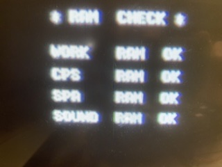

Supergun Student Joined Jan 8, 2020 Messages 149 Reaction score 70 Location Orlando, Florida Jan 9, 2021 #1 What does it mean when you power up a CPS2 B board and it displays a RAM TEST screen? I have a board that is just doing this constantly on power up: Attachments CCFA82C6-8526-4AFC-BA6B-4CD63DD15595.jpeg 18.3 KB · Views: 174

stj Grand Master Joined May 4, 2017 Messages 1,721 Reaction score 883 Location England Nov 10, 2021 #3 i dont have cps2 - but: if it has dip switches - check them if not, check your input circuitry - specially around the test input

Elfito69 Student Joined Jul 31, 2019 Messages 78 Reaction score 65 Location San ysidro Feb 4, 2022 #4 If it get stuck in there is because is not passing Q sound test, check your sound roms
