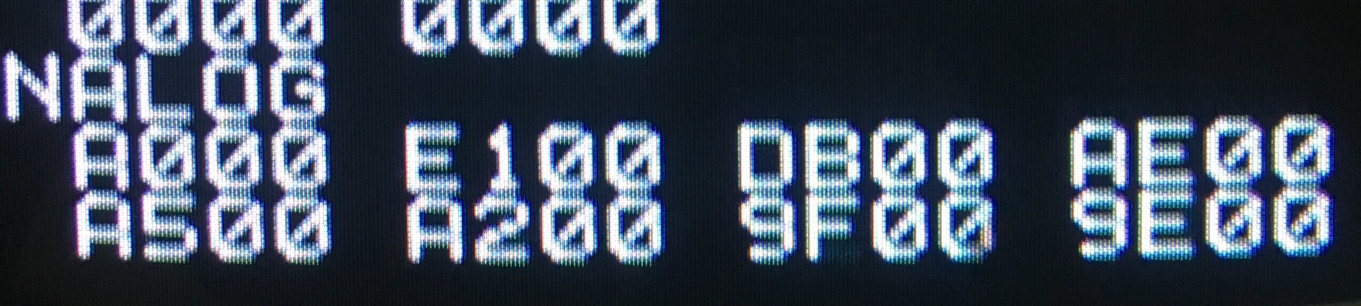

Can you get into JVS test mode (not game test mode) and see how your analog values behave and how your inputs register?
Yes I can get into jvs test mode, I've never used analog controls before so I'm not sure what the screen should look like. When I use one of the analog inputs(gas,brake,or steering) the values change on screen. The first two digits of every analog input is stable but the 3rd and 4th are constantly changing. Is this normal? Thank you for your help.image.jpeg
