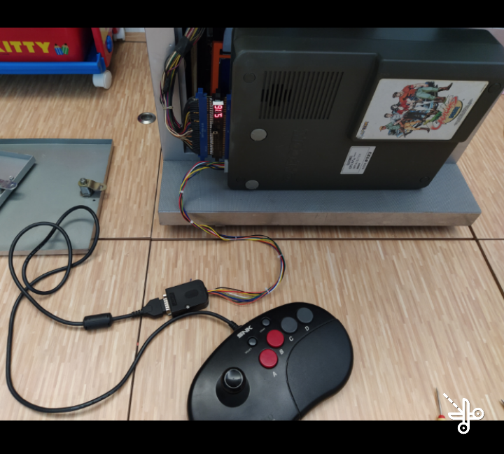

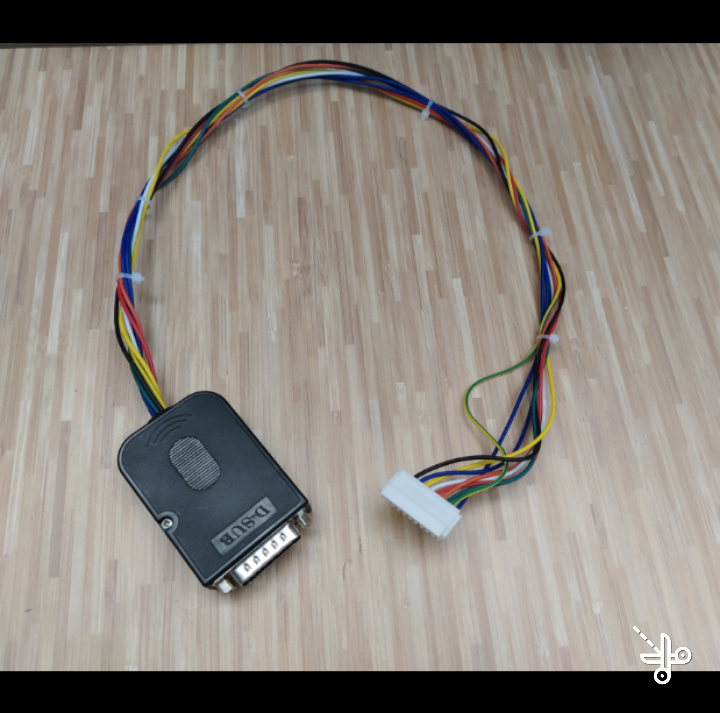

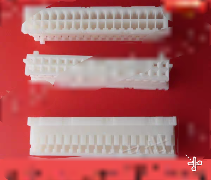

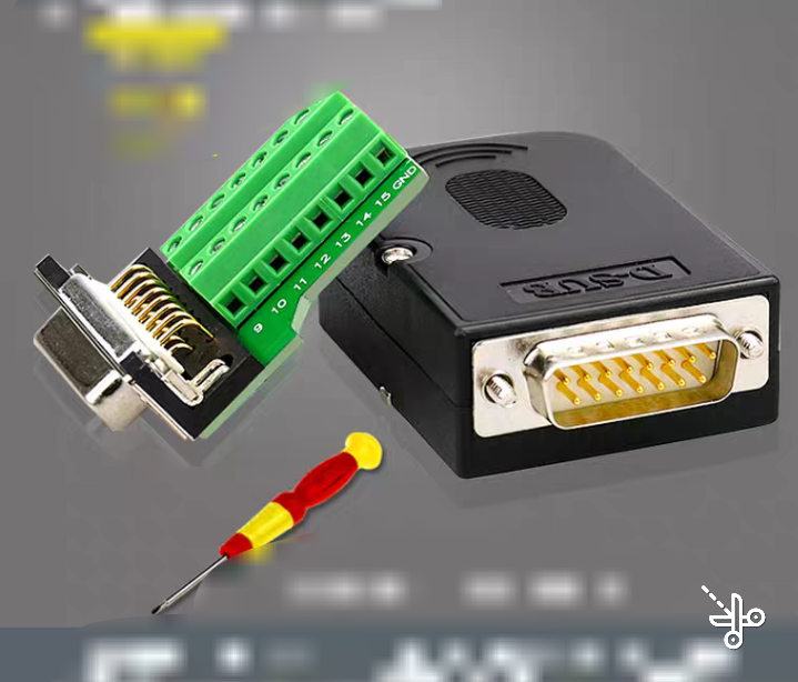

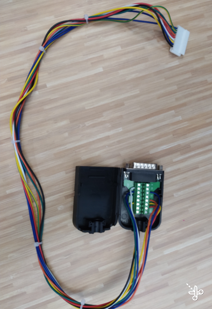

I have the same trick with you when I am playing Irem - Hook PCB. Therefore, I have DIY the 2 cables for player 3 and player 4.
Details for CPS2 P3 and P4 cables:
1. Prepare a DF1B-34DS-2.5RC connector.
2. 22 AWG-22 wires for P3 and P4.
3. Prepare 2 DB-15 pins connectors for connecting NeoGeo controller. 8)
Finally, plug and play P3 and P4 with NeoGeo controller.
Attached the pics of the connectors. Enjoy it. You can PM me for more DIY details.
8) 8) .
However, the weakness of my method is P3 and P4 should use the DB15 pins controller to player the game.
