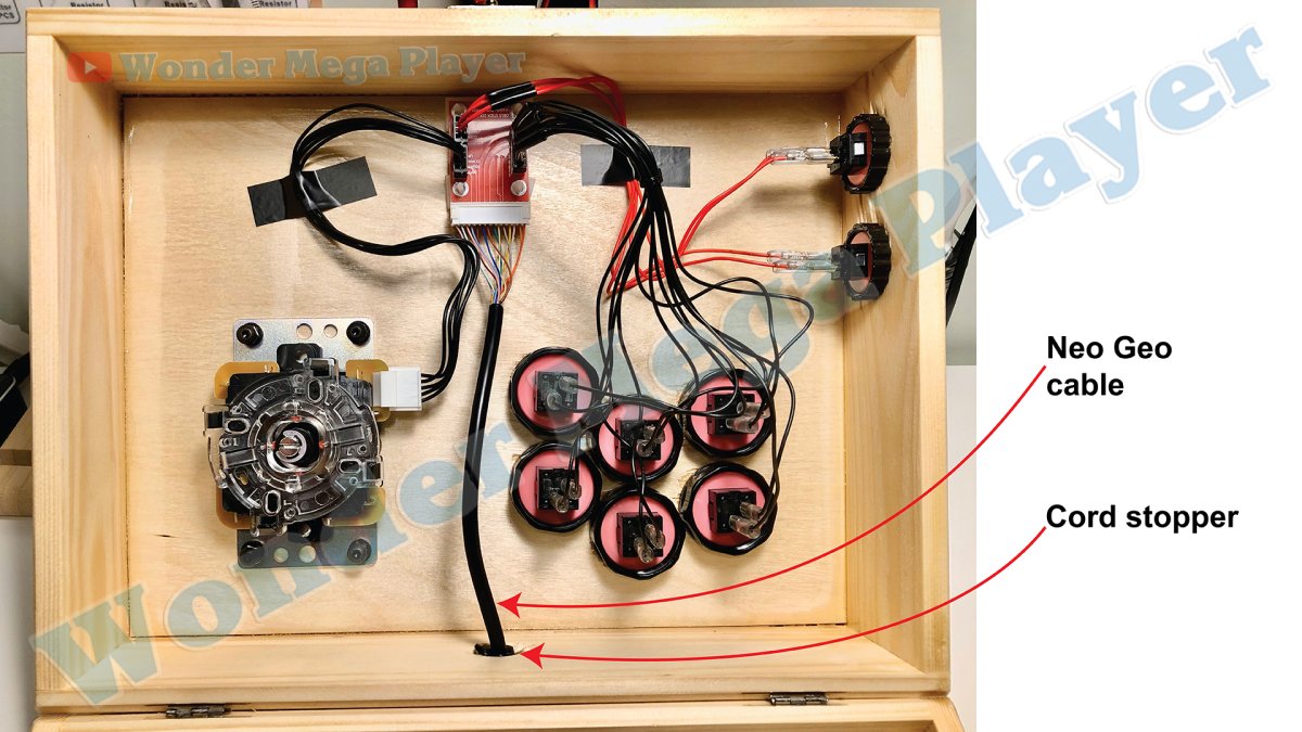

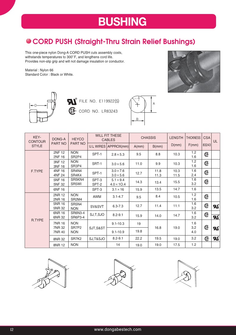

Here's the stopper.
I hope it is the one you are looking for
https://ie.farnell.com/essentra-com...anceMax-High-Margin-Test1573&gross_price=true
The name brand is Heyco strain relief, there is a special plier to “unlock” it also…I have one somewhere I’ll see if I can find a name brand
https://www.heyco.com/Strain_Relief_Bushings/

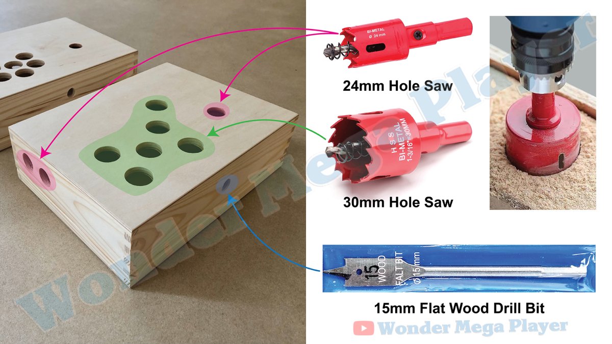

I’d also recommend using a forstner bit to make the holes for the buttons and stick, it’ll be a cleaner hole. They come in all sizes.

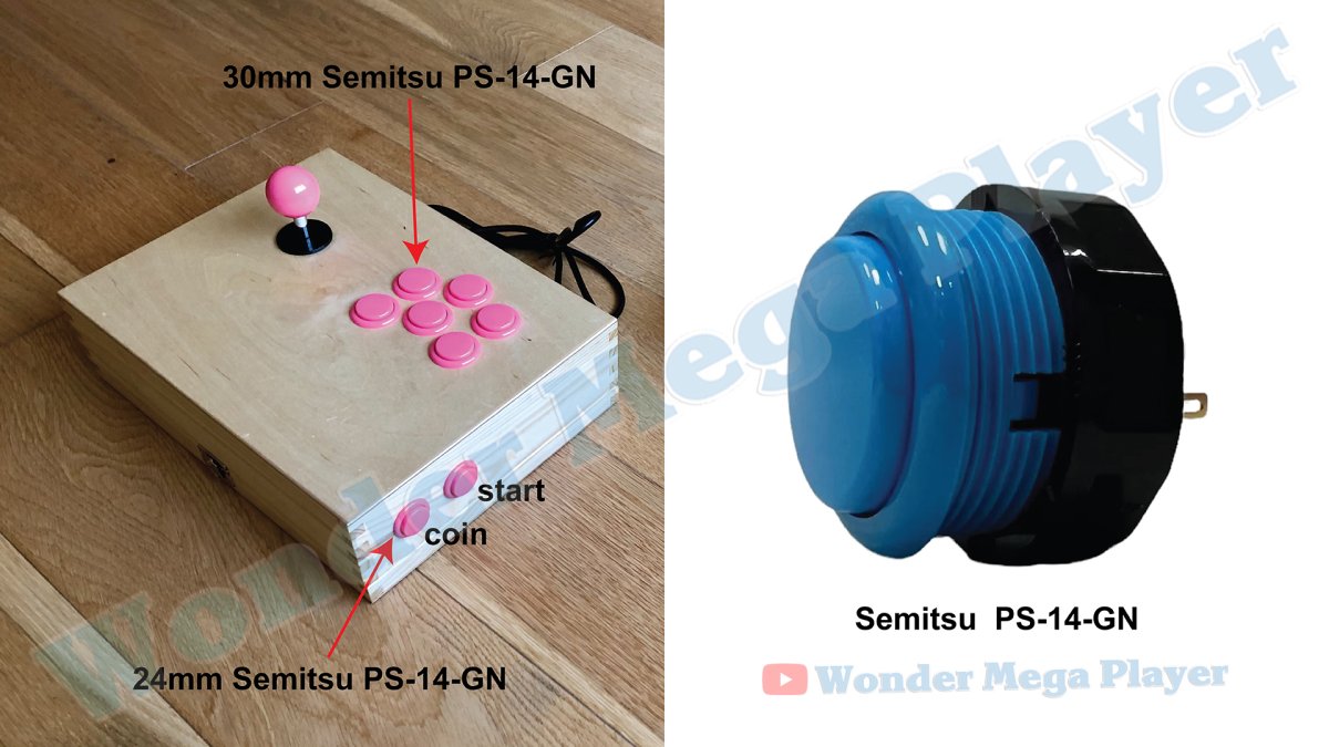

6) BUTTON selection
7) DRILLING HOLES

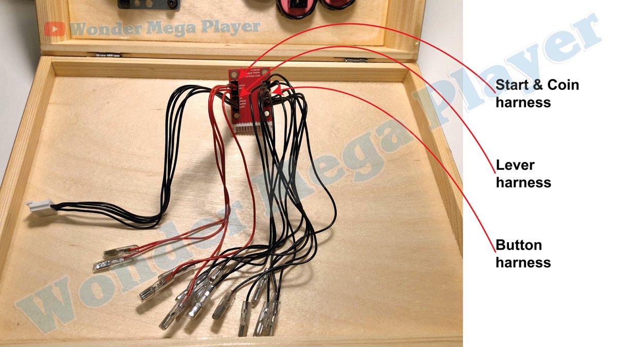

8. WIRING
9) COMPONENTS INSTALLATION
