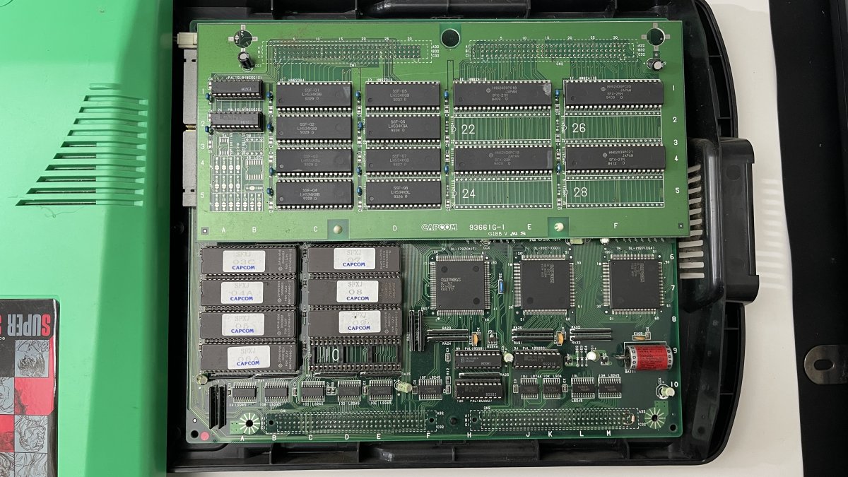

I bought this US Darkstalkers B board from a chap on the electronic bay. He says he thinks it’s a legit board.
But when I got it, it looked off. I can tell the game label is probably real (not a reproduction based on the print dot pattern I can see under magnification) but is on top of 2 other game labels.
The shell also has those cool guy Capcom security stickers. But when I peel them back I’m not sure this is the way they should react. I thought they leave more of a trace behind.
The board looks real but also I’m no expert
What do you folks think?
Am I dealing with a fake ?, a Capcom replacement of some kind? , Did someone use a nicer shell for a board and is passing it off as real? Or even a total chip swap?
Thank you in advance

If the security bolt had never been removed, one end of the bolt would have the Capcom C stamped in it (or is that only A boards?)
Anyway Capcom did convert their own boards, I had a legit CPS2 game with a 2nd label under. But 2 extra labels? Humm. Anyway, in a very quick glance the roms look legit so that's the main thing IMHO. Shell may or may not have been done by Capcom but I'd say the PCB is legit.
(Time to replace the battery. Or remove it entirely in favor of an infinikey or other key writing device!)

It's just all over the place with the factory conversions. Most of the ones I have seen have:
  • Label on the oustide chell stuck over the label of the original game
  • Factory MASK ROMs as if they have been sent a conversion kit
  • EPROMS either with original stickers, handwritten ones or none at all
  • Flux residue where jumpers have been changed
I've seen games like SFA2 -> MSH, SSF2:T -> SF:Zero, MSH -> SFZ3.
The SSF2:T one was a real shame :(

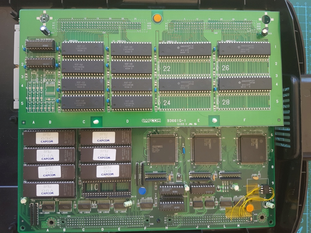

Also speaking of SSF2T this is my board and it really threw me off because I can’t really find a good ref to compare to
