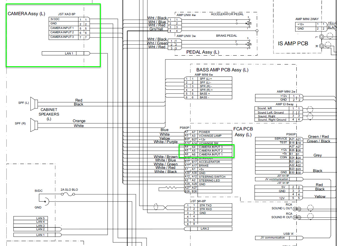

Who's got info on the camera used in Mario Kart Arcade GP1/2?
I see from the manual that it plugs into the Namco JVS I/O board (FCA PCB). That means the picture data is potentially being sent over JVS. That means if the communication protocol can be deciphered, I could potentially work any easy to interface camera into my MEGA JVS solution, and you could have a cheap camera for Mario Kart.
I see that it plugs into the I/O board with 3 wires, but there's also apparently a LAN element, which could make this too complicated. What I'm not sure of is if the camera is simply driven by the I/O board and maybe images come in over LAN, or what... Odd, though, because why couldn't a LAN camera be interfaced with 100% over LAN without involving the JVS I/O?
My hope is that the camera is somehow sending data over those three wires to the I/O and then the images are sent over JVS.

I've been working on a wiring adapter for the Namco FCA I/O to Sega Type 1, and I have come to the conclusion that the 3 camera inputs are going to outputs on the I/O (i.e. the incoming line gets grounded when the output on the I/O is activated). That means the camera PCB likely has 3 inputs that it senses. The I/O would not be receiving any data into it from these lines, and therefore the camera is mostly interfaced with over LAN, at least with regards to images.
I suspect that these outputs are used as a means of initializing and setting the IP of the camera. It's also possible that some commands are given to the camera via these lines.

Knowing that these are outputs on the I/O, I should be able to do some analysis on the output commands over JVS and see if that tells me anything.
I found an "as-is" camera PCB for this game online and went ahead and ordered it. We'll see if I can do anything with it. I have had no luck finding a source for purchasing a known working PCB.
Hopefully this confirms some of your suspicions. On startup, the camera establishes an IP for the camera for each seat. From what I observed, if the cab is linked to others, the stage where PCB1, PCB2, etc are initialized, the camera IPs are established after this point. Each camera IP seems to be assigned a specific range based on the linked units. I might have someone that would be willing to lend a working camera.

The connections to the JVS I/O board are simply acting as DIP switches to set the IP, at least the last numbers of it. There are even some unpopulated DIP switches on the camera board that link to each of these I/O connections, so a physical DIP could be installed to manually configure the camera.
With no DIPs set, the camera defaults to a .100 address. I confirmed that I have my wires connected to the I/O correctly, because the the address of the camera changes accordingly when the game boots or goes into test mode.
The camera board broadcasts its IP address when it boots, and reboots when DIP settings are changed, broadcasting its IP again.

I'm not sure what to make of it. I don't see an obvious error there.
There is also what I think is a higher quality streamer available at http://192.168.29.100/hsview.htm.
This one keeps repeating this in the log file:
network: Connecting http://192.168.29.100/img.jpg with proxy=DIRECT
network: Connecting http://192.168.29.100:80/ with proxy=DIRECT
ERROR: com.sun.image.codec.jpeg.ImageFormatException: Not a JPEG file: starts with 0xff 0xd9
It could be that since the camera is broken, it's not generating a usable jpeg for this stream and maybe this would be working otherwise.
Edit: I can also load 192.168.29.100/img.jpg in my browser, but it's just blank. Perhaps this is the URL for a single still generated at the time the page is loaded?
I'm not sure there's much else to do with the broken board. @jlazaris has offered to let me borrow a working board, so I may hold off until I get that.
