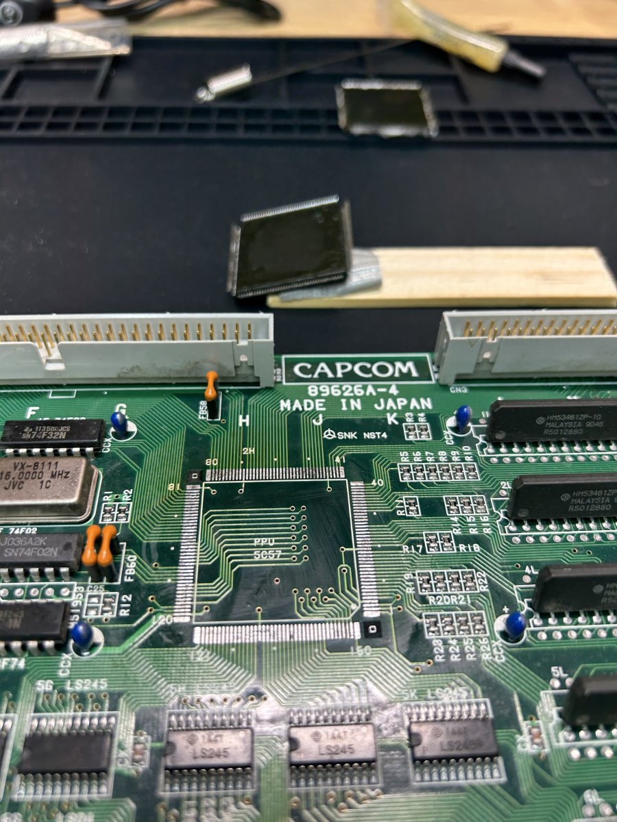

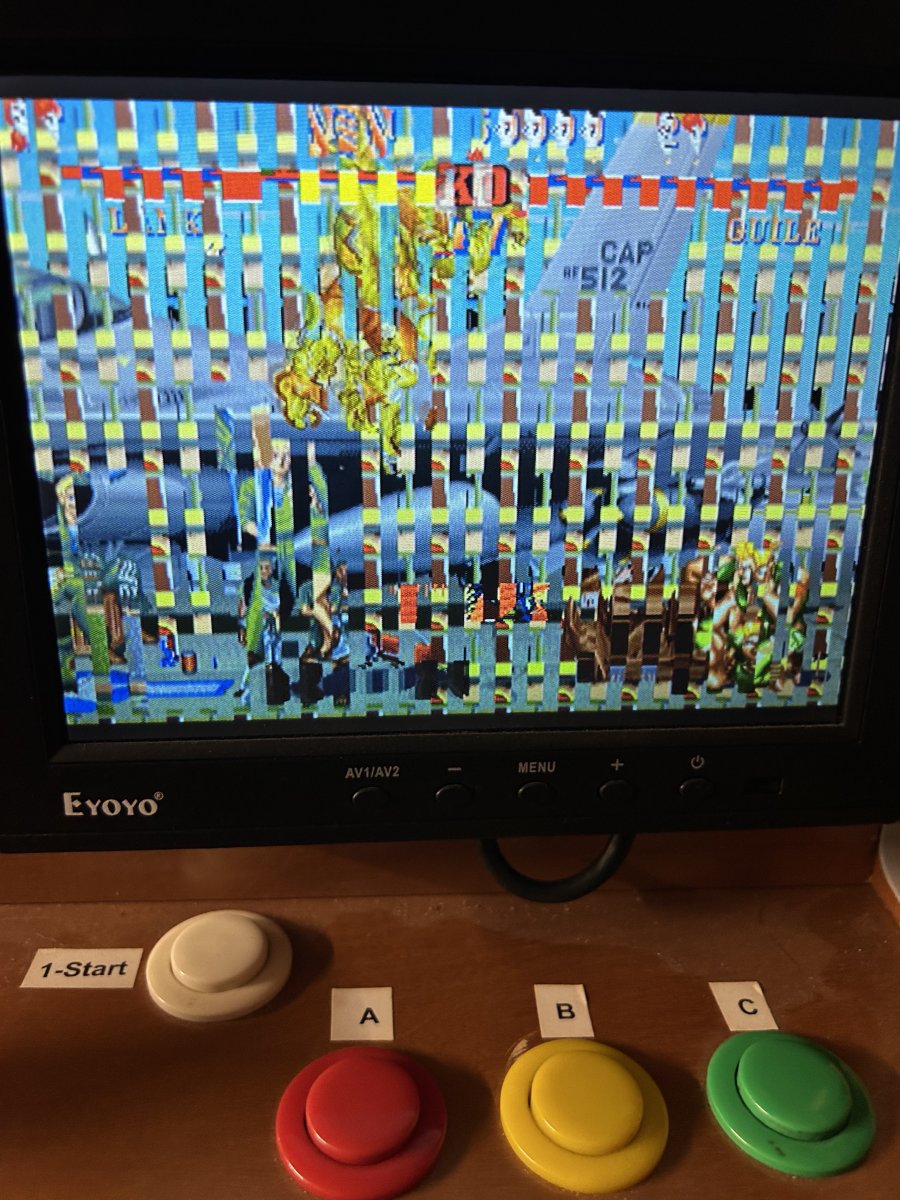

I’ve flipped the board stack and felt the various Ram chips, nothing feels hot. I’m going to probe the ram in the board, but does this look like A-01 failure?

Check the B + C boards with another A board if you can. If the same B + C works fine with another A board then I'd definitely say that it's an A-01 failure.
Sorry, I should have included more detail; this B&C stack is known good. Thanks, I was pretty sure but I wanted to get some other opinions before I try to replace it.

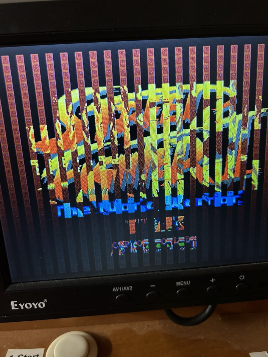

Fun update. I swapped the a-01 from a dead donor and now this board doesn’t boot. For funsies, I installed the garbled chip to the previously dead board and now it starts with the same issue. So I guess the dead board was due to a failed A-01. Fun practice. Im going to shelve this one until I find a know good a-01 from my stack.

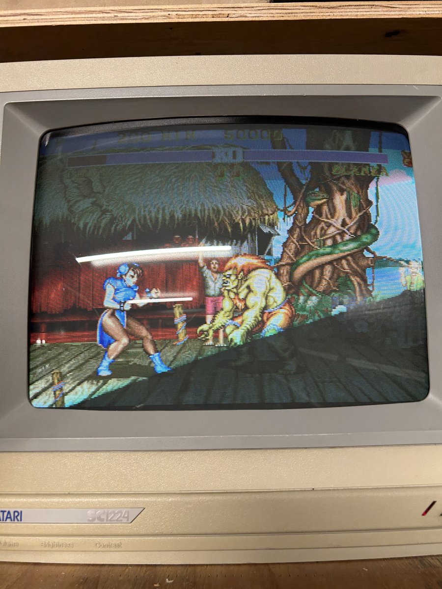

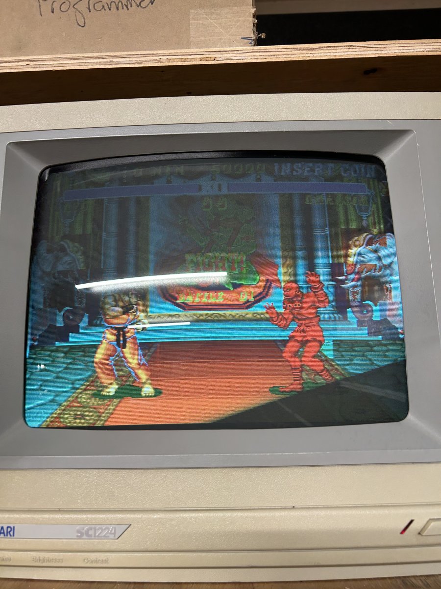

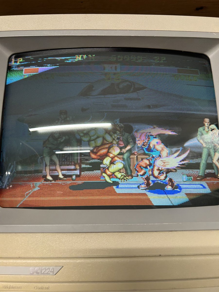

Here’s another one. It’s funny because certain characters are all messed up (ryu and dhalsim) while others are perfect (chun li and blanka)
